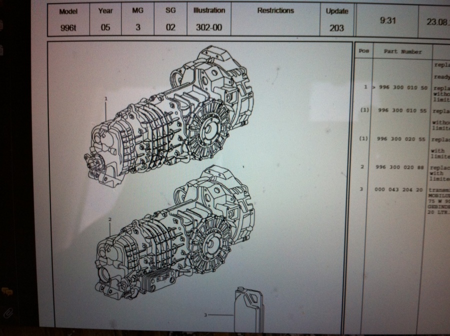

Is this the same for 996 GT2? in terms of recommended gear oil and interval? Also any technical differnces to be be aware of? I have a nice built RS gearbox and want to take care of it properly to ensure it's good health over time
See the attached pictures. This info is straight out of the 996TT/GT2 Porsche PET parts catalogue. You can check the part number of your manual transmission, with or without LS. Mobilube PTX 75w90 applies to both. Considering the cost of our gearboxes, to me it's a no brainer to take the guess work out of what product to use. I looked at the specification of a lot of the 75w90 gear oils compared to the Mobilube PTX (and Shell Transaxle), and they are both much thinner oils at low temperatures with a higher viscosity index than the regular Mobil 1 75w90 or the Delvac. In other words the OEM stuff flows better at low temps. Will it make a difference? Who knows? But there is probably a reason why Porsche had it formulated the way they did. I'm not educated enough when it comes to oils so sticking with OEM makes sense to me.....
John I didn't see any attached pictures buddy
Sorry, I realized I didn't attach them but they are there now.
