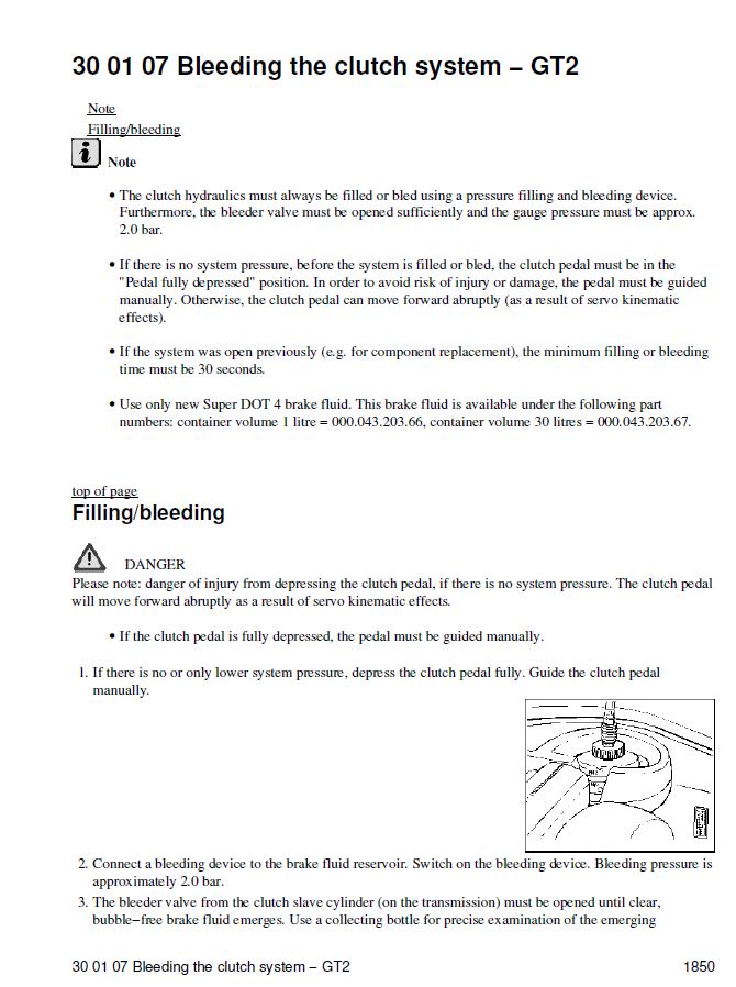

Old Mar 2, 2011 | 11:40 AM

Old Mar 2, 2011 | 12:38 PM
tvurt's Avatar
Posts: 712
From: Akron, OH
Rep Power: 58
tvurt has much to be proud oftvurt has much to be proud oftvurt has much to be proud oftvurt has much to be proud oftvurt has much to be proud oftvurt has much to be proud oftvurt has much to be proud oftvurt has much to be proud oftvurt has much to be proud of
Here you go:
Old Mar 2, 2011 | 12:55 PM
bsprad's Avatar
Joined: Jun 2010
Posts: 151
From: Maryland
bsprad is infamous around these parts
crap. Is this from the Porsche manuals directly? Thanks for finding the reference. I couldn't find it anywhere.
Old Mar 2, 2011 | 01:15 PM
tvurt's Avatar
Posts: 712
From: Akron, OH
Rep Power: 58
yup you can download them from the sticky at the top of this forum.
I would first flush with DOT4 then replace your slave, master, and the GT2 hose.
GT2 slave part number 996 116 237 90 ($125.25)
GT2 master part number 996 423 171 06 ($64.50)
GT2 hydraulic hose 996 423 377 90 ($115.25)
Tom
