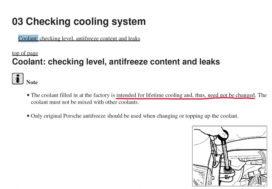

Originally Posted by Duane996tt
The dealer has said the engine coolant last "forever". This is just not
plausible. Nothing mechanical last forever especially associated fluids. Maybe they just want to sell you water pumps and radiators when the coolant turns bad. Anyone have a real world idea of coolant change intervals on a 996TT. As an aside, BMW and MBZ also said their tranny fluid is good for 100K. Fat chance with all the wear parts inside an auto tranny. Why do they perpetuate these myths.
THe dealer was right! Look at this page from the repair manual. But, I guess, and this is a guess, the coolant loose his property with time like oil and grease etc....
