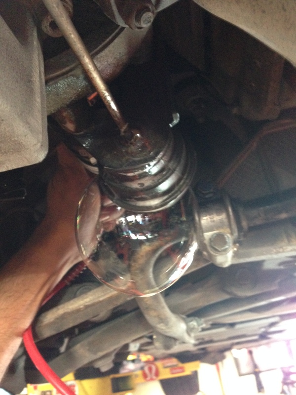

I did a leak test on my car and it would hold pressure for more than a couple of seconds. After lots of searching I found this...
Would this result in a large loss of power even if I am still seeing 1bar on the gauge?

wastegate rod seal? I have the same issue on mine
