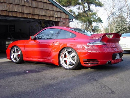

I've got them and my car sits pretty low. Does anyone know if these have a bump-stop installed to prevent the tire from being able to hit the wheel well? If I'm on it and hit some pretty rough pavement that requires a bit of wheel travel at a high rate of speed, there is a loud thump that I hear at the moment the car becomes light and then settles back down. There has never been any rubbing in my wells, which would seem impossible without a stop and considering the height I'm at. TIA
Here's a side shot for height:

The original H&Rs do have bump stop in them. Unless someone removed them you should have them in place. The bump stop was move of a measurement to prevent the shock from bottoming out rather than stopping the wheel from hitting the fender.
