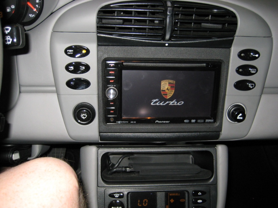

Here is mine. It's an older model Pioneer AVIC with custom bezel. Had the ipod link routed to the tray.
