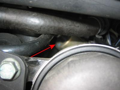

If you have adequate oil levels but your oil pressure gauge is below 5bars at above 3000rpms then most likely is loose wires going to the oil pressure sender or a failed oil pressure sender. The oil pressure sender is right behind the oil filter.
