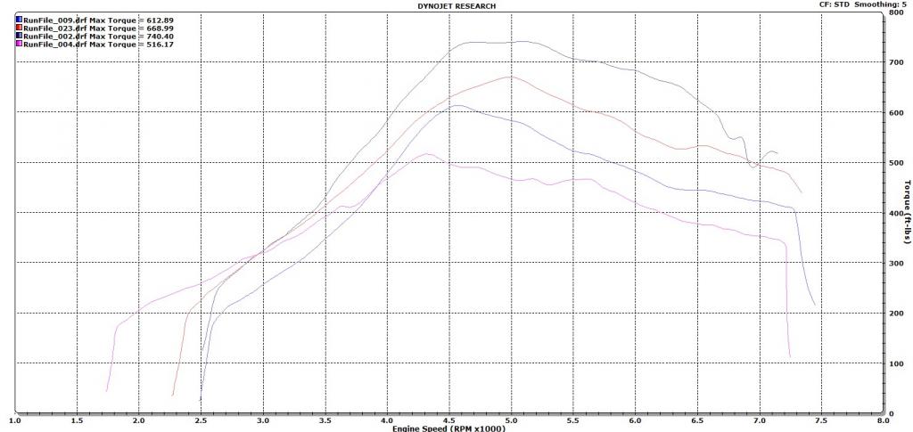

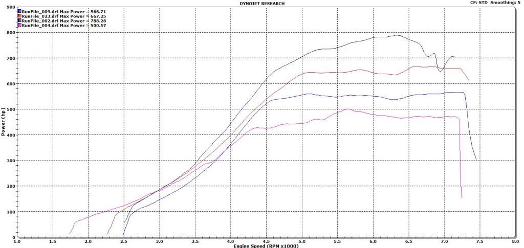

Anyone willing to discuss this further with simply claims and no data it won't do anything but spread misinformation. As for Rob Tuned results they are vbox verified like everyone elses. What results are you talking about that aren't?
I am willing to discuss with some data, speaking of data I haven't seen you post any empirical data to back up anything. Itguy has posted quiet a bit of data on this forum actually. You claim 7163 will spool much slower than X, you have anything to back that up. Back in 2013 handful of people used to argue that Alpha28 was the best spooling turbo ever, I said that a 3076 would spool the same and make more power..... So i went out and got some results. I suggest you give it a shot.
If anyone has a BW EFR Dyno they would like to send me I can overlay it with these files.
-A3076, 28psi, E85, Tony@EPL tuned, X-Pipe
-A28, 24psi, MS109, Tuned, X-Pipe
-K16G, 22psi, MS109, Tuned, Exhaust
-OEM K24, 15psi, 93oct, FVD Tuned, Cargraphic Exhaust
A3076 aren't spoolin that slow. Are they really BIG turbos if they spool faster than stock?
Enjoy..
dip at the end was a 044 going bad on my car.

Thanks for addition with some data. Looks like those 3076 come on real nice . Like I said earlier to its hard to say blank is faster than blank unless if the exact same car with the same tune. So many thing you can do to affect spool that is not apples to apples.
BTW nice power on those graphs.

So not trying to be a jerk but you know e85 is somewhat self oxygenating meaning it's like having a small shot of n2o in the fuel not to mention how much you can advance the timing and run higher compression... the graph looks good but it's apples to oranges if no one else is running ethanol or methanol blends.

i am fully aware of what you can do with E85 and what the benefits are.
apples to oranges would be overlaying a 996TT graph with a GTR graph, A28s were ran on race gas so its not THAT big of a deal. its far better than hypothesizing on what "tad slower" spool is.
not trying to be a jerk but..... you got something better to show us?

If you honestly want to compare spool and torque curves again you need the same car and same tune just a turbo swap back and forth.
Also on a fair note you should compare similar sizes like an a2871 to a 6758 or a3071/76 to a 7163
