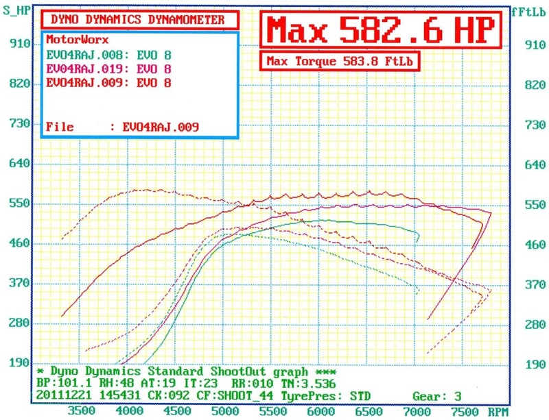

This is a back to back test done on a evo engine comparing EFR/BW and GT turbos. The only change was a turbo and the efr got a different manifold to make use of twin scroll.
RED EFR 8374
Purple BW S200sx
Green GT3076

Twin scroll comparison makes no sense here as it'll help a lot with spool and it can't be done, at least not in a way that makes sense, on a boxer type engine like ours.
