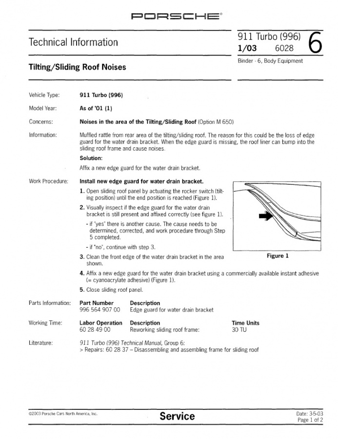

I have a rattle somewhere near the sunroof area. Doesn't rattle all the time, and it's seemingly random as its happened at multiple speeds at multiple rpms. I thought it was the plastic housing of the dome lights or the ir sensors next to them getting loose or even my radar but it's not. It's friggin driving my nuts.
Ok ok some people will complain about my TSB's but I have to post it just in case There are 2 TSB's for the sun roof. here they are!

Originally Posted by jpflip
Ok ok some people will complain about my TSB's but I have to say it just in case There are 2 TSB's for the sun roof. here they are!
Is that only for 2001 model year cars or all Turbos? I have some occasional noise from the sunroof as well.
