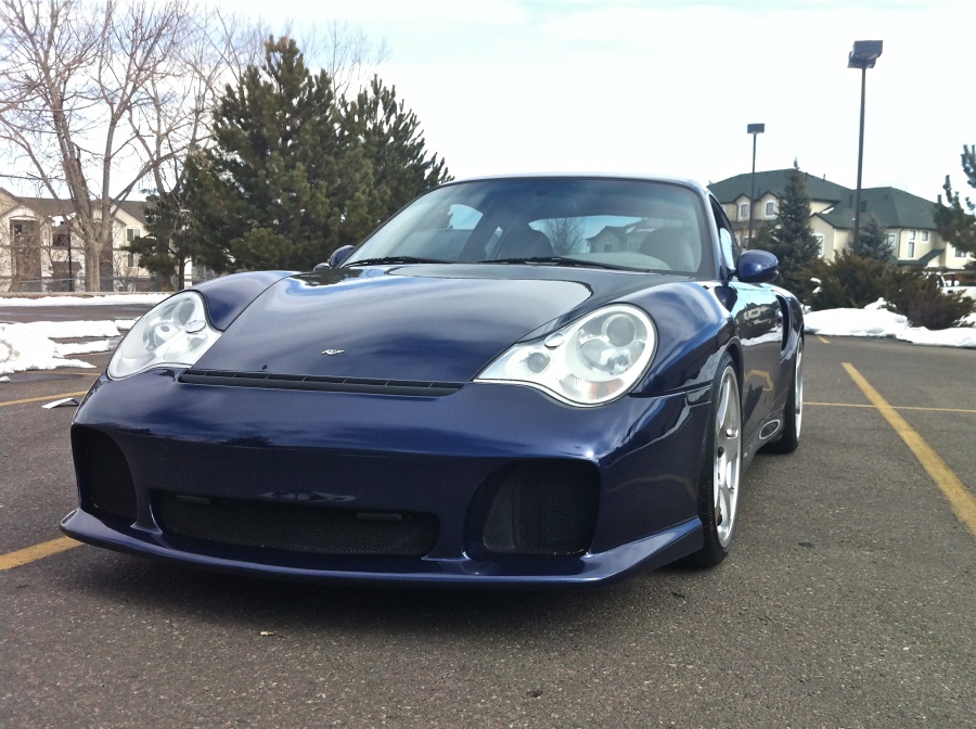

Old Apr 3, 2012 | 07:07 PM
pwdrhound's Avatar
Joined: Jul 2010
Posts: 4,848
Rep Power: 457
Originally Posted by prodigymb
I had 8.5 , 9.0 and 9.5 fronts and 11.0, 11.5 and 12.0 rears over the last 5 sets of wheels I had on my car. My advice is based on my experience and not info I regurgitate from other threads. Suspension setups and tire brands/sizes vary too.
Your negative camber up front helps fit a 9 for sure along with a nice aggressive offset. Can you post a pic of et39 front. I want to space out my current set in the front a bit.
Here is a picture of the 19x9s and 19x12s
