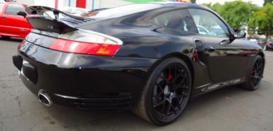

Thanks for the info and I got a clean bill of health from GMG today so I pulled the trigger on the 2001... 49k miles of pure joy!
Here is the first photo, I'll post some more up later!

No solid spoke factory wheels, HRE P40's.. damn, that's a nice upgrade!! I think I got a good deal on this one and it's super super clean for a 49k car.
