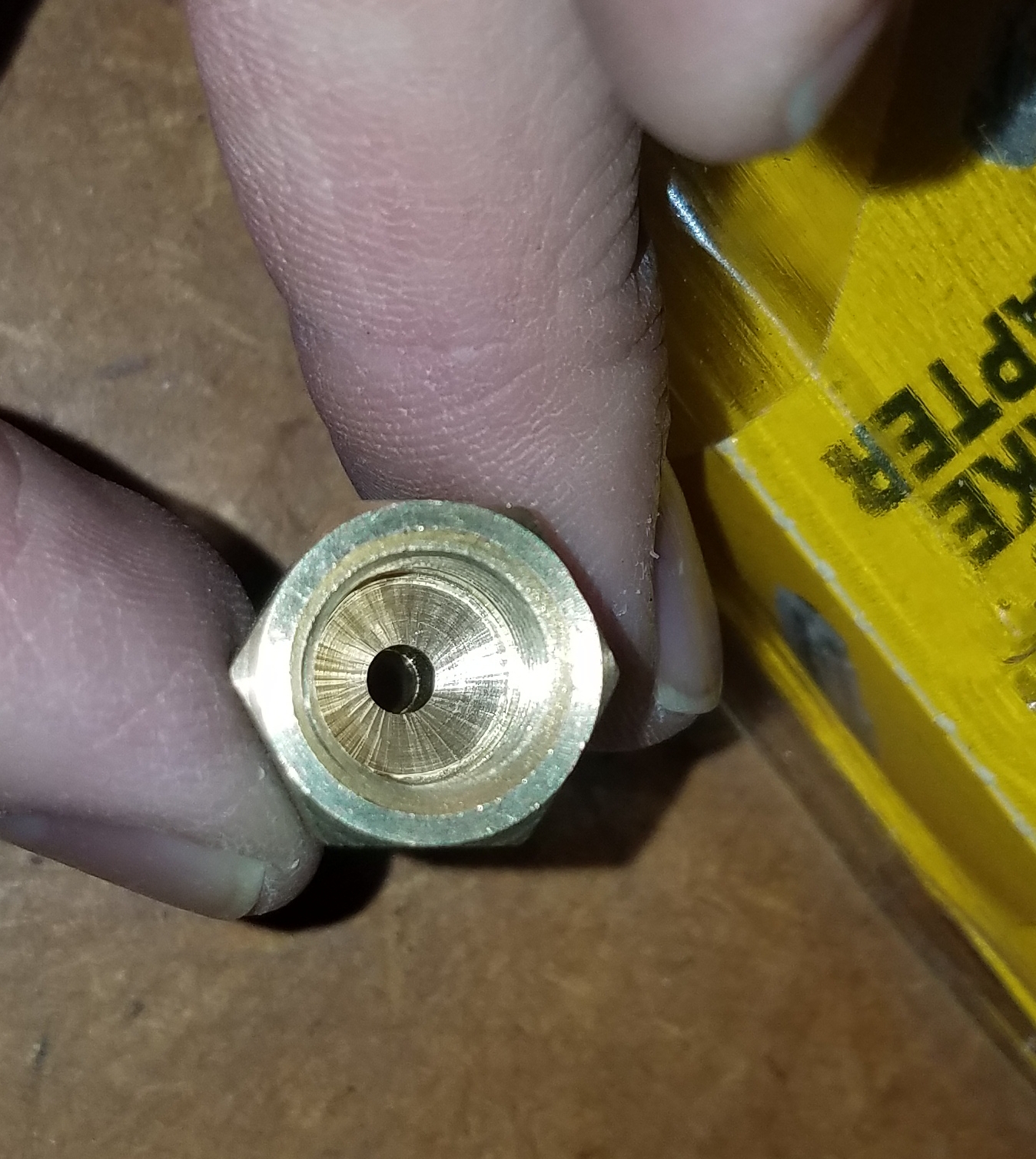

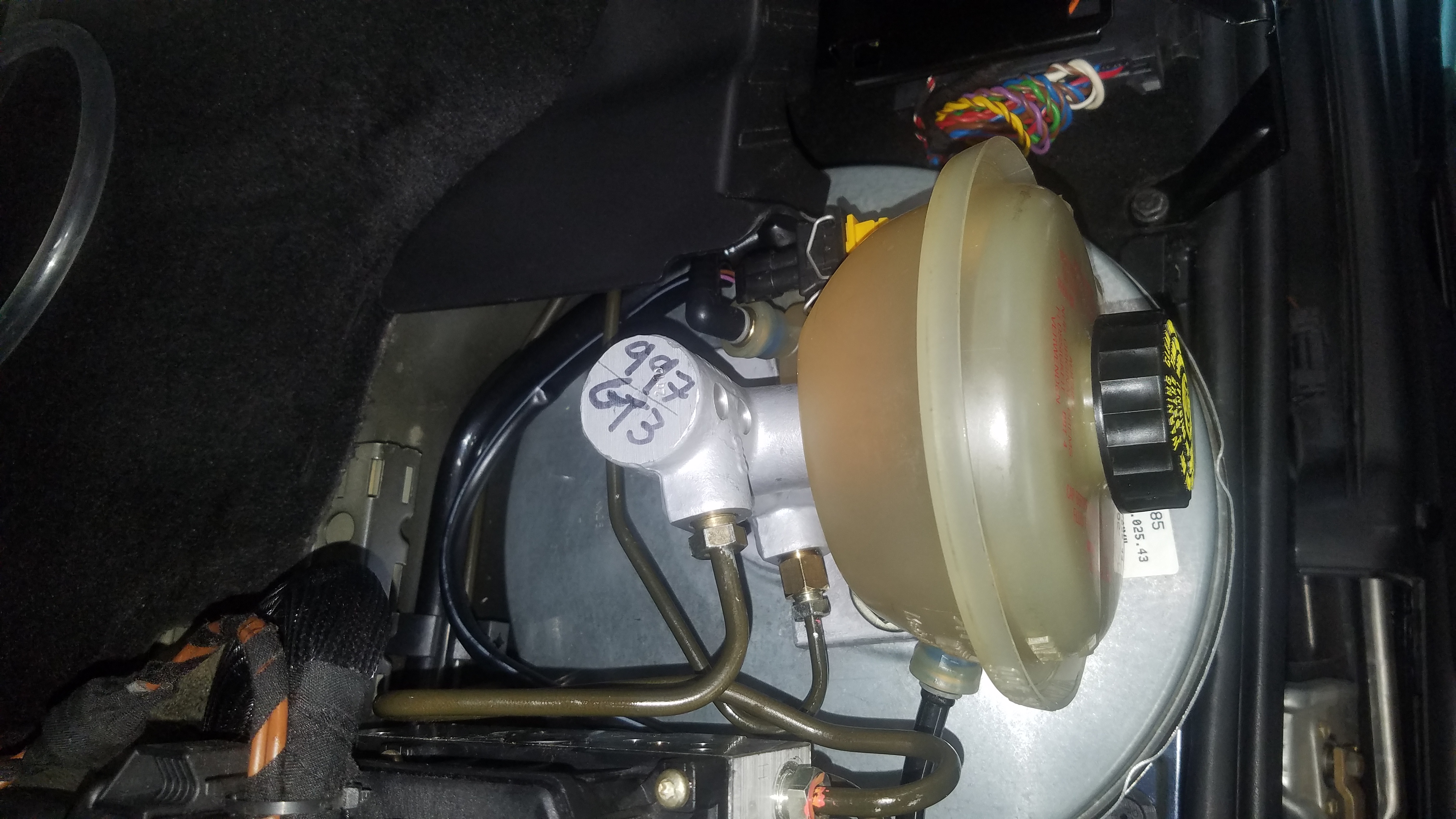

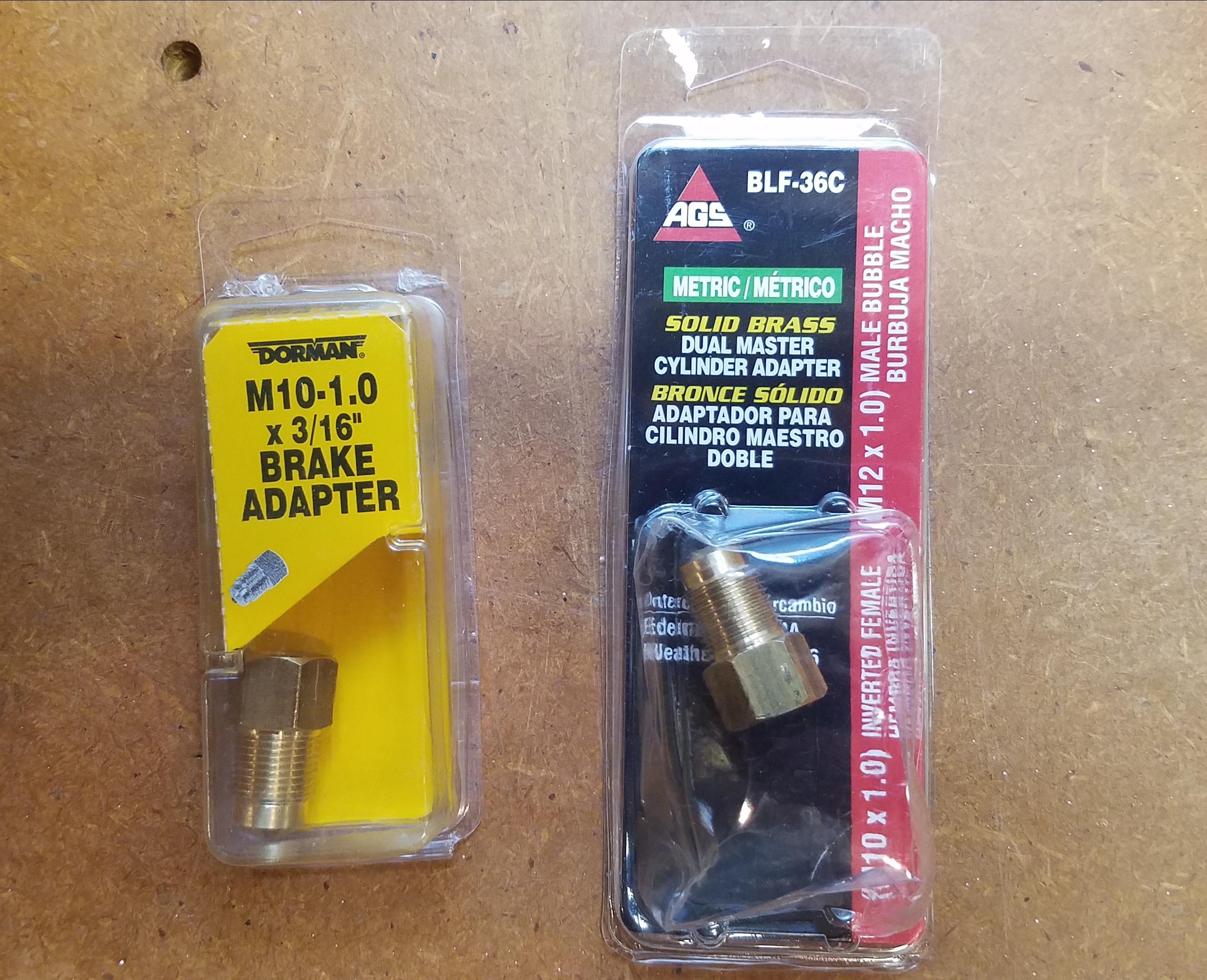

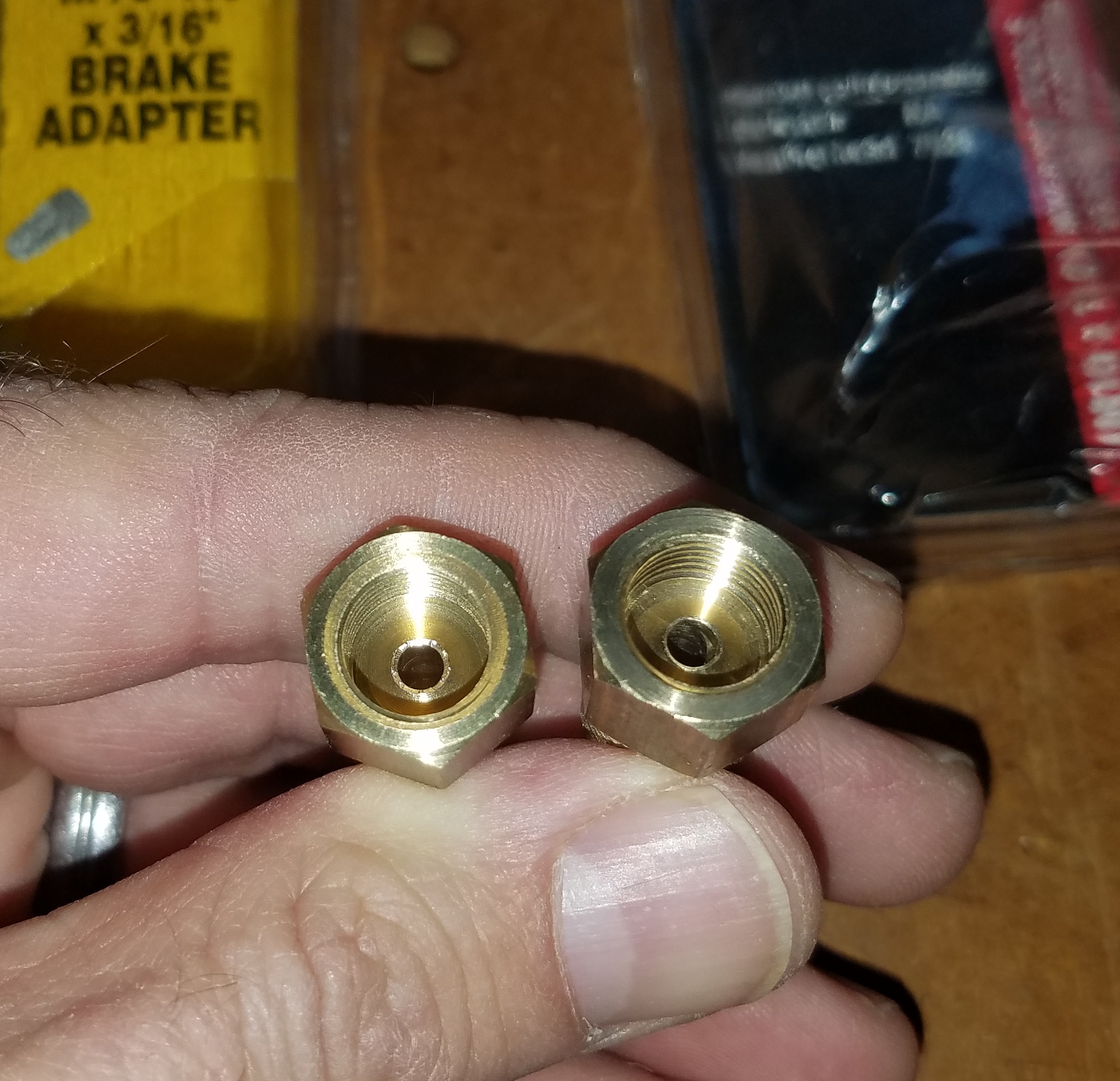

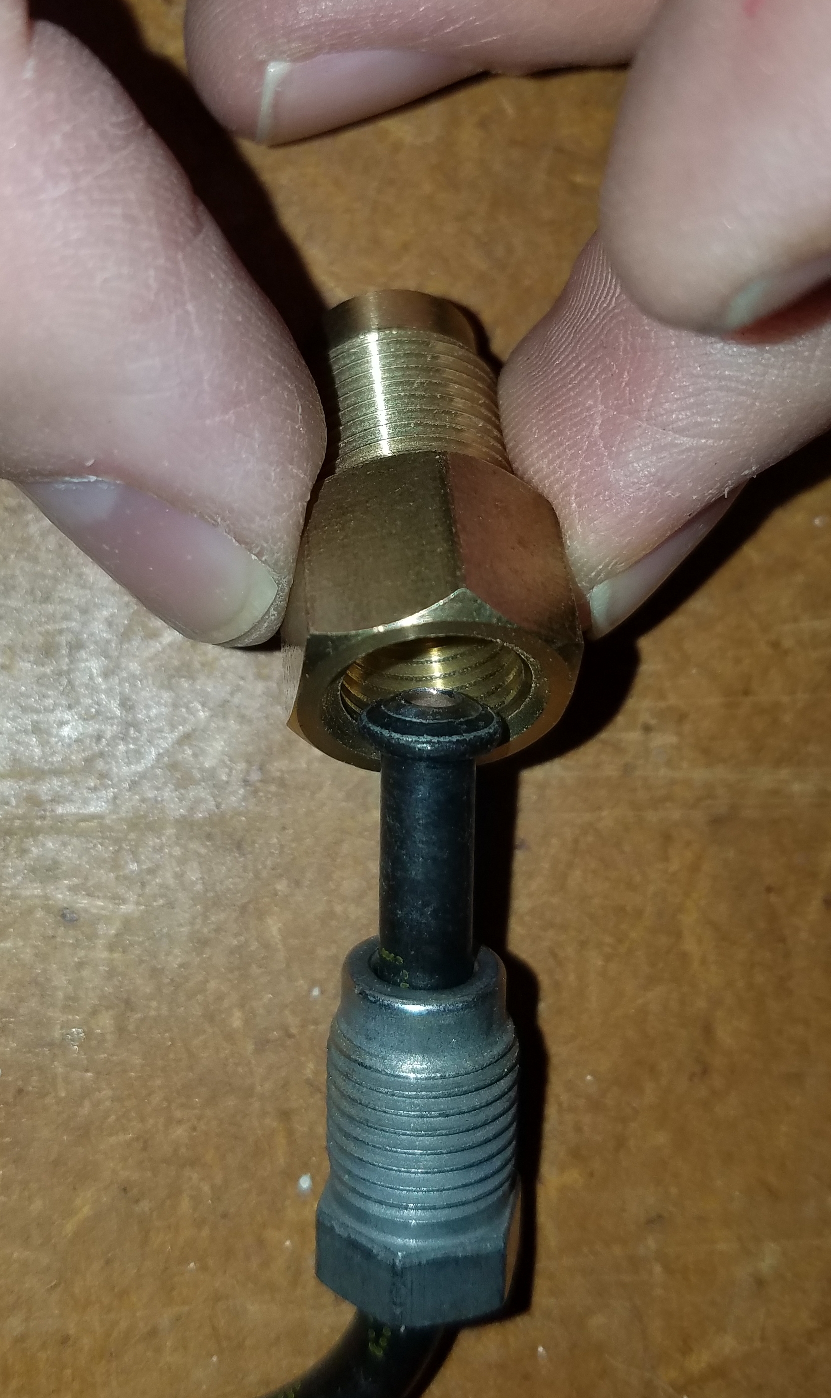

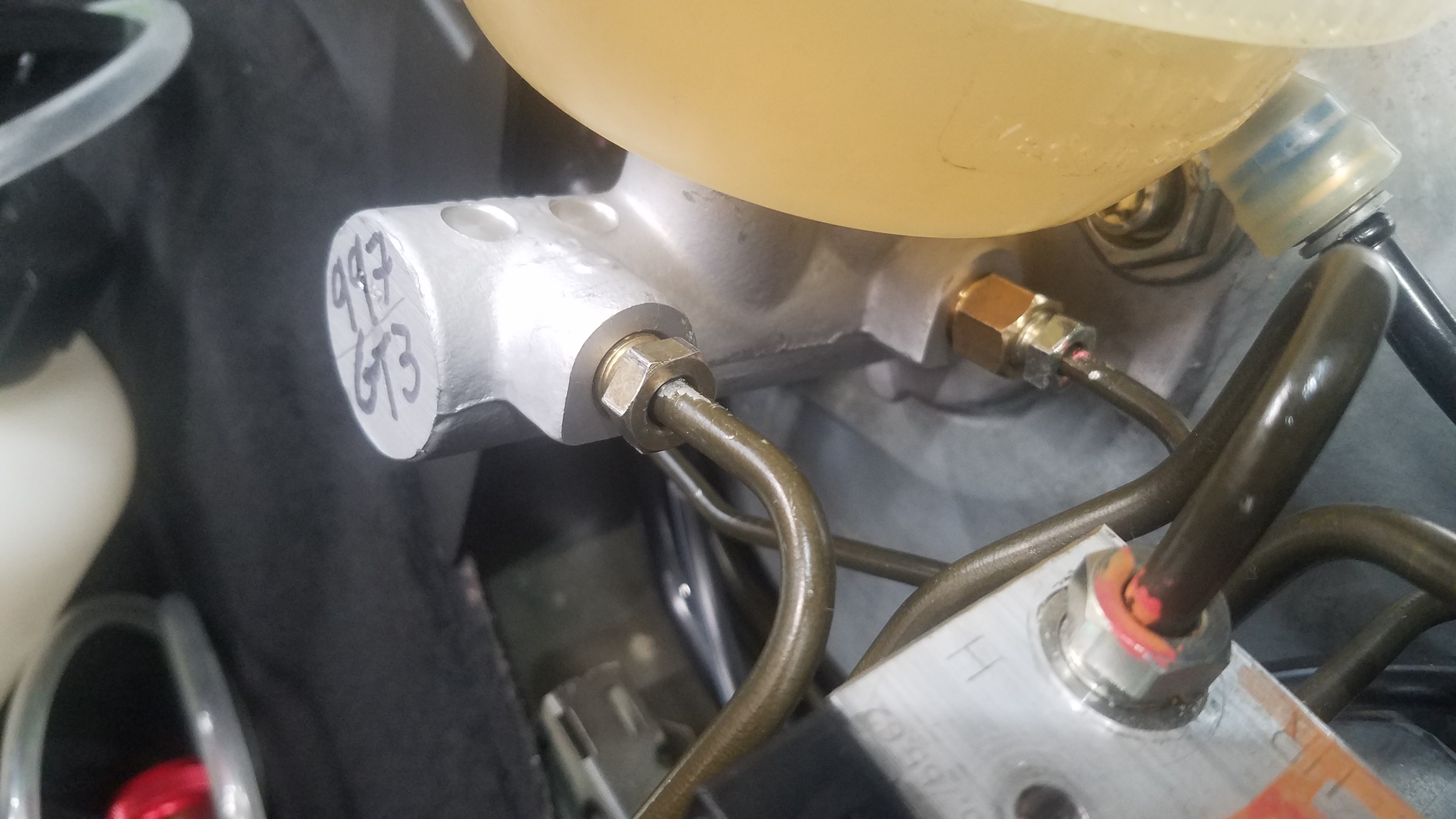

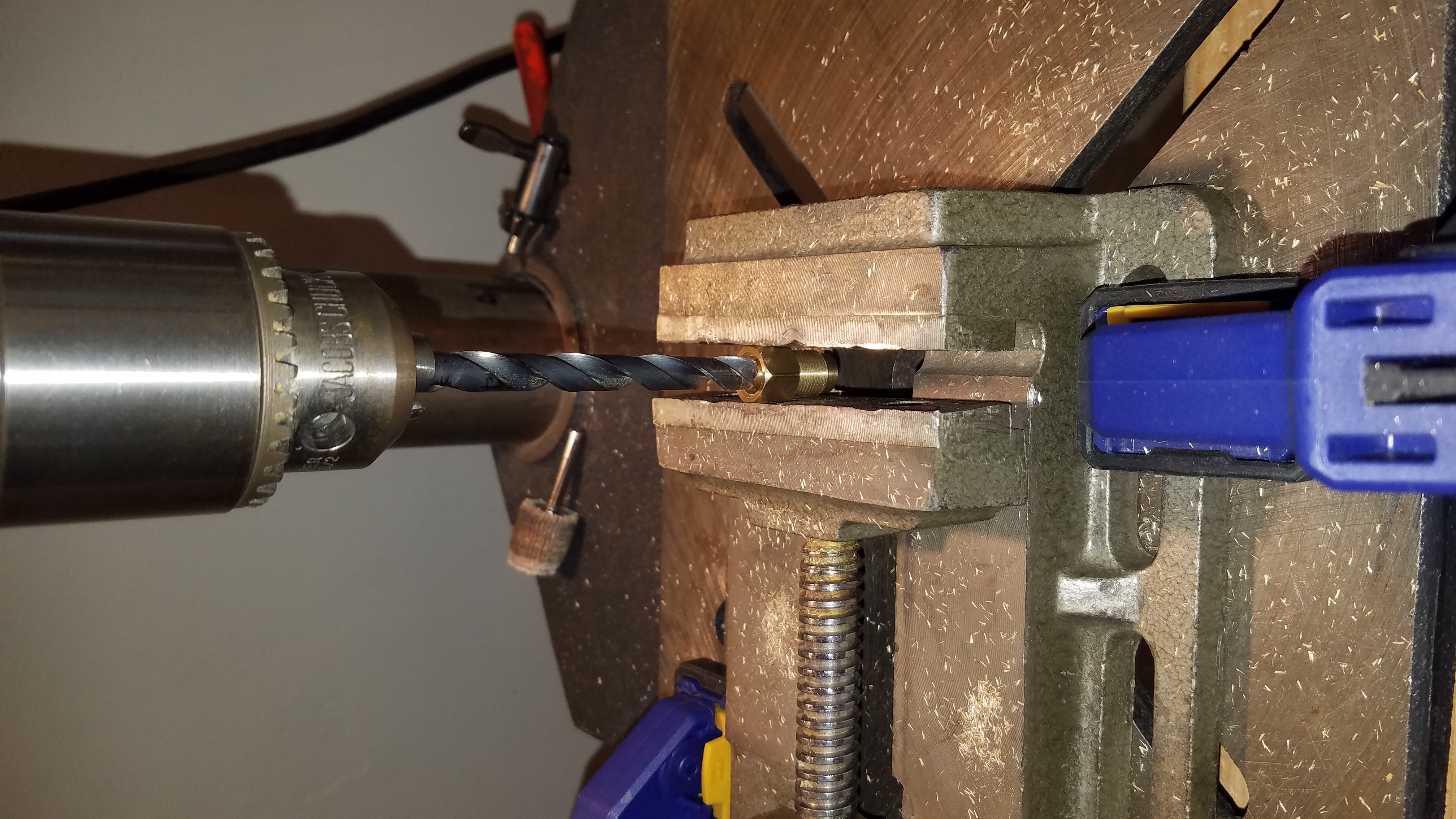

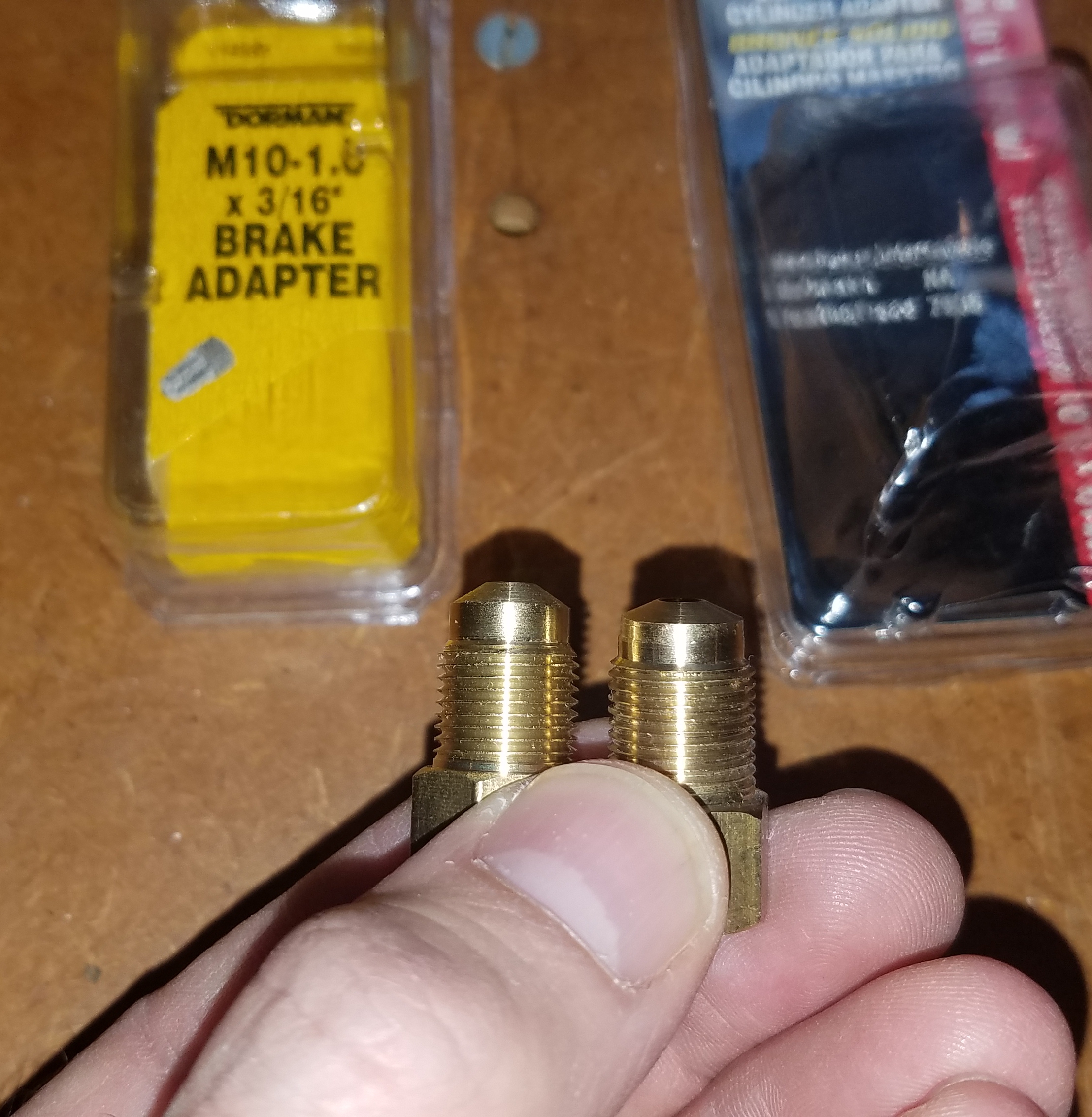

Reviving an old thread. I usually post on Rennlist and not much here but since this thread was helpful I'll add to the knowledge base.
I installed the 997 GT3 master cylinder in my 2003 996 C2 today. Yes I realize this is the TT and GT2 forum but the cars are similar enough and this thread was the most helpful one I found out there. My main goal was to reduce pedal travel and squishiness which I don't like when on the track in my 996.
The dual M12 ports on this master cylinder presented the same challenges to me that have been posted here before.
Unlike most of the cars posted here my car has the remote PSM booster pump way over on the passenger's side rather than under the master cylinder. This means that there is a very long brake line coming off the M10 rear circuit with lots of bends so I decided to use an M10/M12 adapter rather than make a line.
I found that there are two main M10/M12 adapters out there on the market, one made by Dorman and one made by AGS. Both have a bubble fitting on the male M12 end, but on the inside M10 female end they are milled to receive an SAE fitting, not a bubble (european) fitting going in.
I found that the Dorman adapter was a bit deeper on the M10 female portion than the AGS, so the Dorman one is the best one to use as it will engage the most threads.
I mounted the adapter under my drill press and using a 21/64" bit modified to cut brass, running at high RPM (2300) I turned the SAE female M10 internal surface into an internally tapered bubble (euro) surface. You can Google how to file a drill bit for cutting brass w/o gouging.
This worked out great and everything bolted up really nicely. I tested with very hard pedal pressure (standing on the brakes) several times w/ no leaks.
If you have the skills to do this it makes the install easy and the resulting reduced pedal pressure and travel is excellent!
Photos attached....
