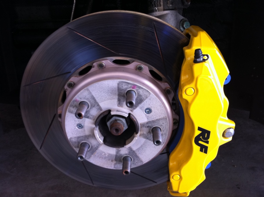

My car came with the RUF 7mm spacers which are the only thin spacers made that have the hubcentric lip on them. They are pricey at around $200 for the pair but well worth it. The RUF part number is R96 331 611 07.

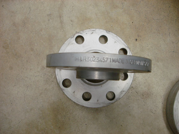

https://www.6speedonline.com/forums/...nted-know.html
7mm non hub centric leaves enough "hub" to work great. You need hub centric spacers after 7mm. Make sure you use the correct bolts!
Non hub centric
Hub Centric:
