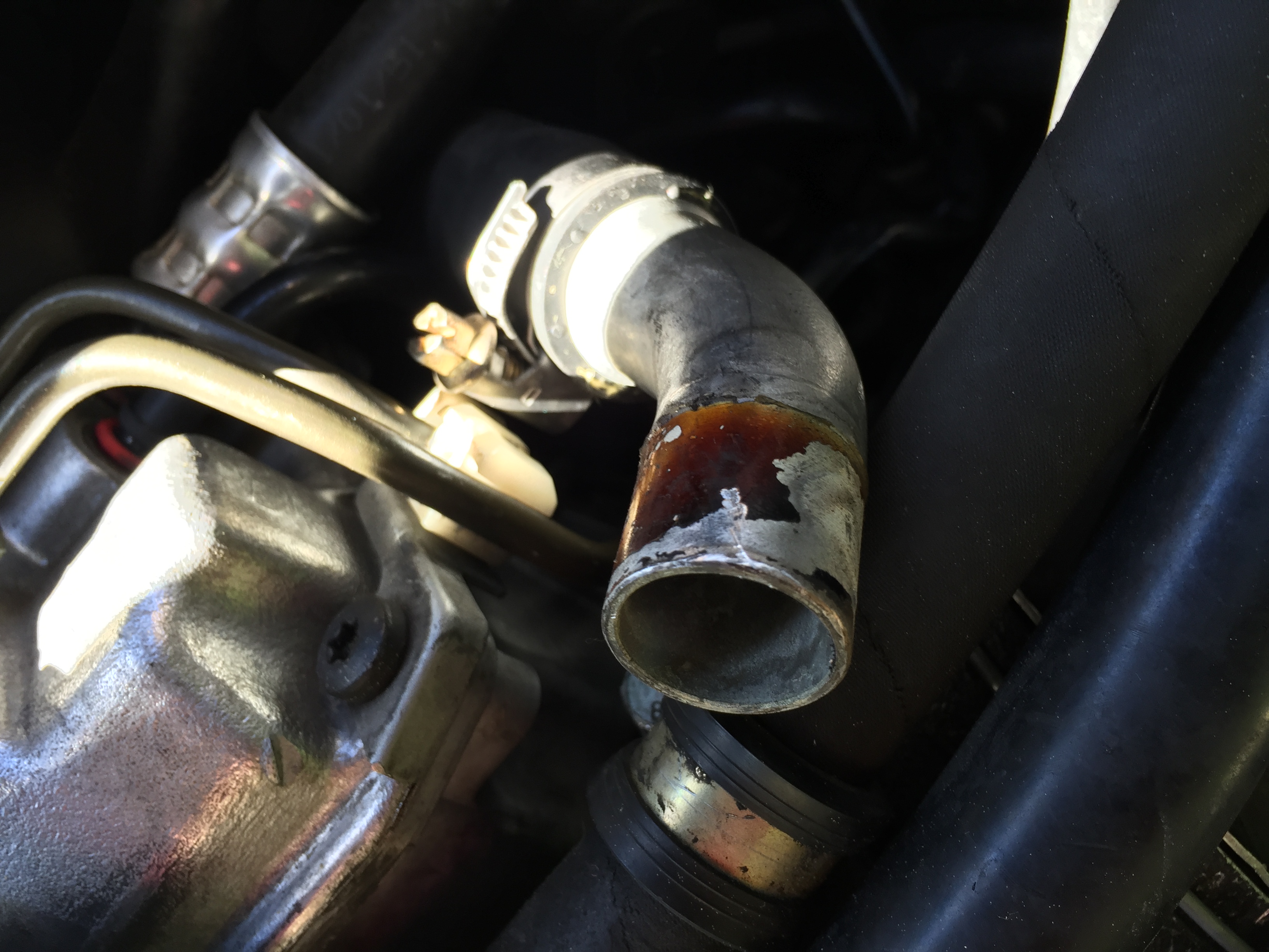

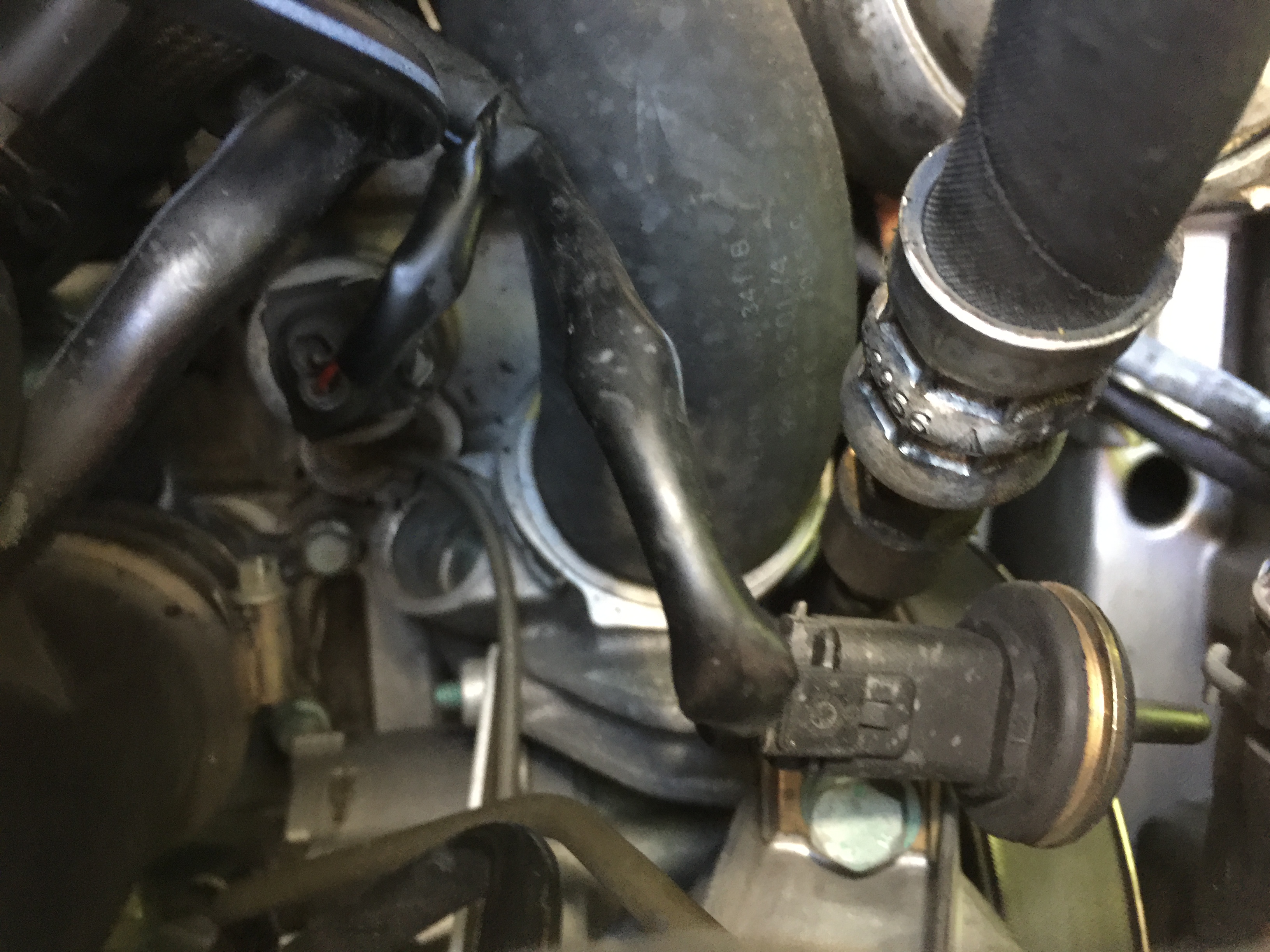

A friend lost one of his fittings today, he called me sitting on the side of freeway on the way to work.
Got him running with a temp fix, will be helping him pin the fittings very soon.

When I lost mine, it was the area you are referring to.
His fitting was on passenger side in the PS pump area (attached pics).
FWIW, if you are mechanically inclined, I pinned my car without removing the engine completely- disconnected mounts and lowered it a few inches was all it needed. It was harder than basic maintenance, but certainly wasn't the most challenging thing I've ever done.
I wouldn't replace it with a new factory part... Porsche never addressed the problem from my understanding. As far as pinning vs welding, plus and minus to each method I suppose. There's a lot to read on that topic. I chose to pin given the information out there and for simplicity sake.
Depending on how you use the car and what your acceptable sphere of risk should determine your method going forward. If you track, auto-x, drag race, or push the car hard regularly... Do it. Too much at stake to leave it untouched should something go wrong IMO.
Mine failed driving home from work after my first track day, cruising steady state on the freeway. My friend's car has 110k miles, original owner, never been tracked, no modifications, it failed sitting in traffic; he said he had barely been above 3k rpm that morning. This week is our first hot weather of the year up in our area, maybe a coincidence?
