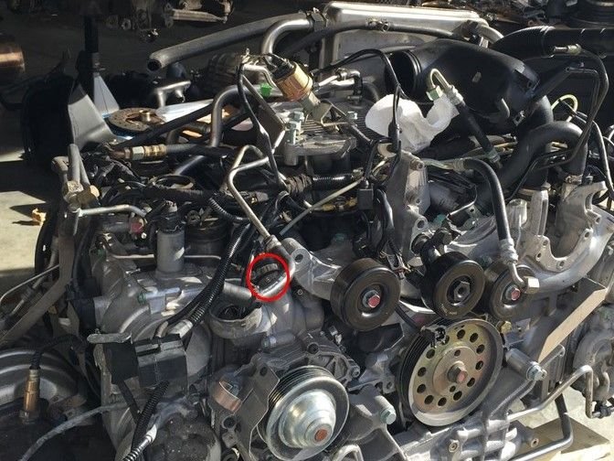

How can I tell?
I have a 90,000mile 2002 996TT. I bought it recently, and probably didn't do quite enough research on common issues for the model prior to purchasing (got to the "it doesn't have the IMS issue" and moved on).
The vehicle had a number of owners and I don't have totally complete records. Is there an easy way to tell if the lines have been pinned/welded? Are any of the junctions easily visible by just opening the engine bay? Any suggestions as the easiest one to look for?

The fitting next to the coolant hose may be the easiest to see. Here is my engine after I had pinned the coolant fittings. You can see the head of the allen head screw in the circle. Basically you should see a screw or weld in this area.
Later, Steve
