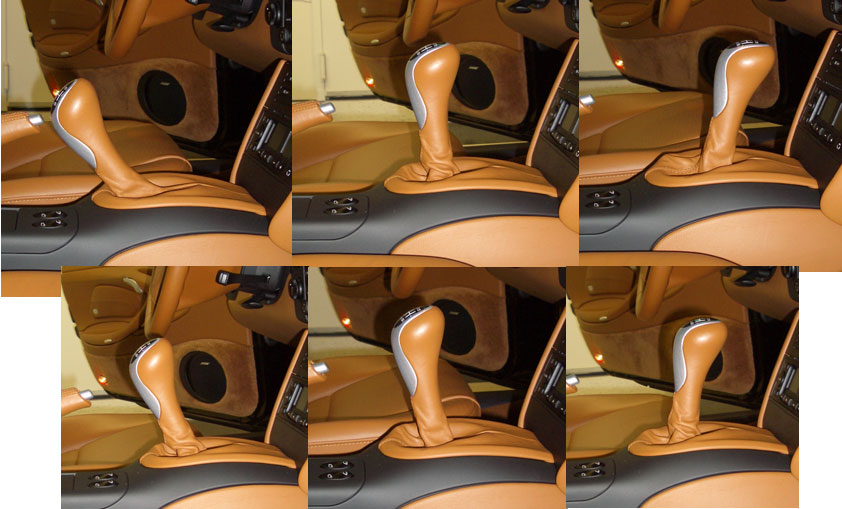

At the advice of the forum. I got the short shifter.
BIG BIG Difference!!!
Top row is before, bottom is after.

I see that it is a big difference. Do you like it, does it make shifting easier, did you install it yourself, and how much was it?
BTW, I like the color interior you have, is it special order?
Thanks
I do like it but the force needed to make the shift is certainly higher and notchier.
Definitely gives more feeling to the shifter. you can really feel the engagement. In contrast, the stock unit feels rubbery.
I think within a week I'll forget how the stock shifter felt as far as force and then it will be perfect.

Looks from the pics as if most of the shortening is in rearward movement from neutral . Doesn't seem much different going from neutral into 1st , 3rd, 5th . I recall a post that said the under car kits shorten the opposite direction , allowing you to combine kits . Am I right ?
it may not seem it in the photos but the forward throws are definitely much shorter.
