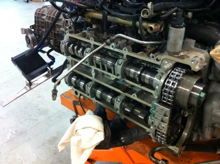

Ok, so the cam covers are off and camshafts are coming out next. Just as my mechanic told me, it is the #3 cylinder on the drivers side. Specifically one of the hydraulic exhaust lifters is bad. You can press on it and it collapses fairly easily so it looks like the internal spring is bad. Everything visible including the cam lobes look to be in perfect shape so that's a relief. Now they just need to pull the right side and swap out all 24 lifters and assembly can begin. Should be wrapped up in another couple of days.
John, I have heard sticking lifters in american cars often, and it can be loud when you pop the hood. Is the sticking lifter in these cars very noticeable even over loud exhaust and LWFW? Also did you get pics of the overall car and area as they do the work? I'd love to see that.
check the exhaust valve under the lifter...i am wondering that a exhaust lifter fails
maybe the reason is a def exhaust valve or spring
Yes, you will definitely know it if you have a sticking lifter even with a loud exhaust. It is a fairly pronounced ticking or rather clicking sound and you can definitely isolate it to one side of the engine or the other as opposed to a loud IMS for example which comes from the motor itself. I've got some pics when they were putting together the gear box cooler, LSD, and other stuff. I'll post it when I get a chance..
