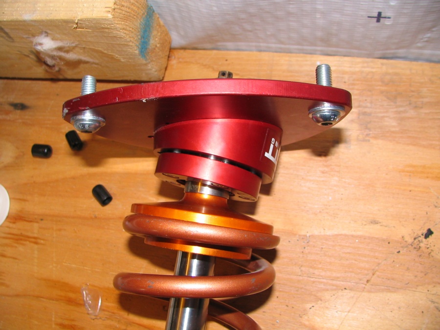

well on my car it replaces everything and the top plate that holds the spring on the coilover is the last needed part from the coilover.
i'll try to see if i have some pics at home.

here it is with my Moton
