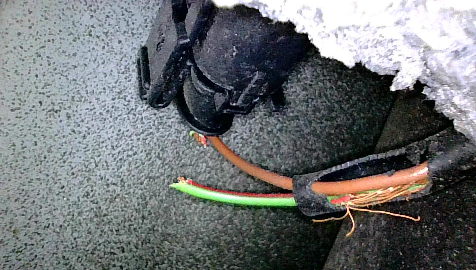

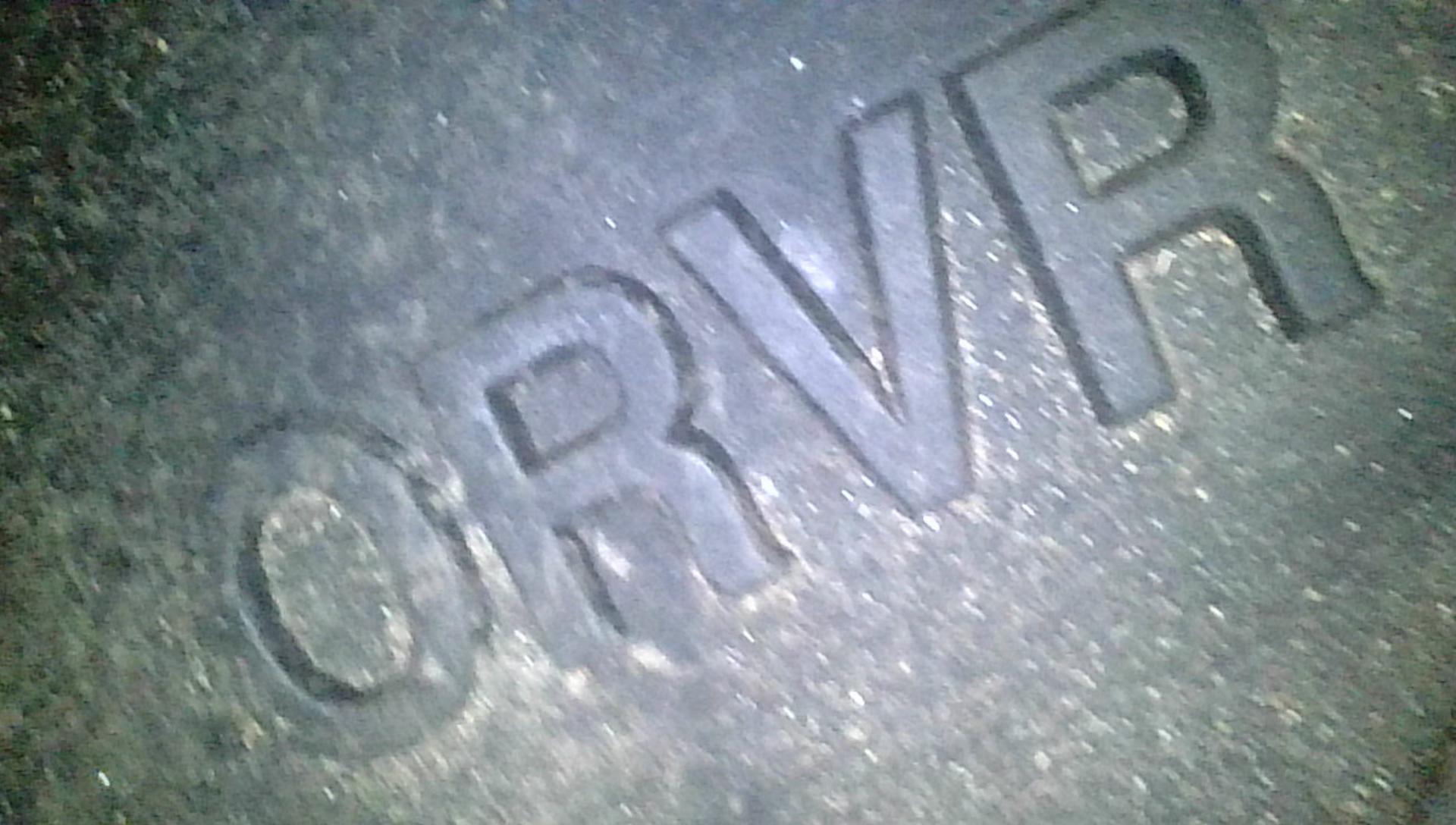

I think I found my problem!!!
Using the new acquired CCTV camera and slowly checking everywhere around fuel filler, inside passenger wheel well' s cover, under battery tray and finally remove carpet at the front trunk and look through a little hole under the CDs changer where the fuel tank vent valve is located (also known as ORVR) look what I found.
The old mice chewed up the wire that is supposed to connect to the fuel tank vent valve (996-605-203-01). As a result, it caused the valve to shut off all the time and therefore I only can pump fuel very slowly (55 min to fill up the tank by pushing down the tap at the filler neck at the same time to release pressure).
Now the next phase of figuring out the way to fix this is going to be interesting because the little hole that I sticked the camera in is only one inch in diameter. I'll have to gain access to that location to unplug the electrical connection and rewire the truncated wire.
I've read somewhere before that a member enlarge that hole to ~ 4 to 5 inches by cutting the aluminum section around the hole (black drawing) to change the defect ORVR valve.
Other than enlarge the hole, the official way to gain access to that location is disengage the steering, drop the front suspension and drop the fuel tank (seems like a lot of works).
I would welcome any suggestion of how to approach this problem.
Thanks
BV
