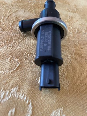

Yes @jpflip that was the post I read about a few month back.
@JSBear I'm still trying to figure out how to solve this problem. I think the problem is the hole is too small to try to slip through the connection after un-snapped the wire connection and fish out the broken wire. I'm very familiar with this type of connection because recently I was able to reconnect the same connection on the engine for the knock sensor on bank 1 and 3 without dropping the engine. I'll need to spend more time trying to retrieve it first before decide what to do next.
Picture of new fuel tank vent valve which I may not needed after all and an old picture of the connection to the knock sensor of the same type of connector.

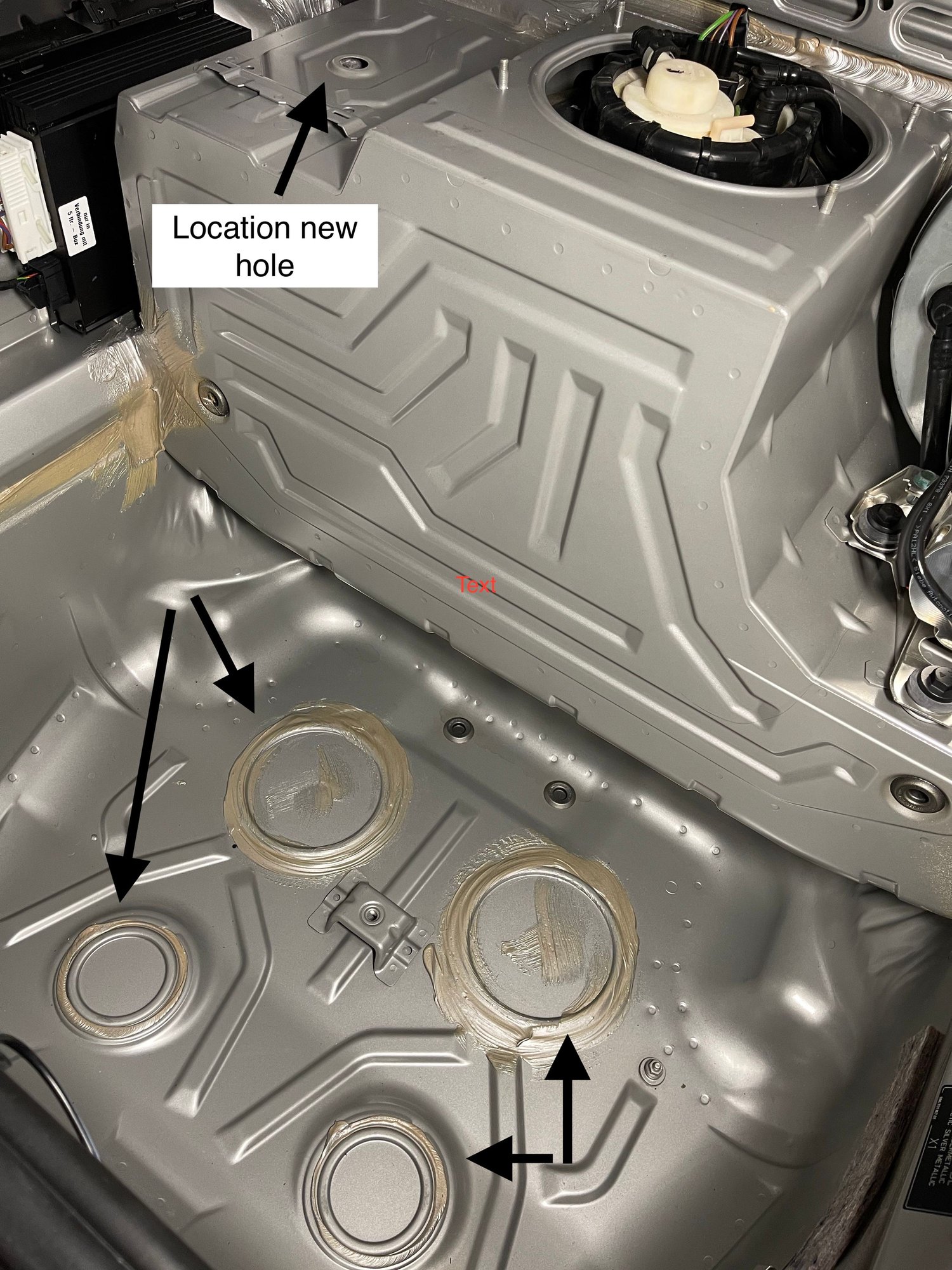

Yes I agreed. But too bad in my case which was diagnosed to be the problem is at the hardest location to reach, the fuel tank vent valve electrical connection which is above the tank and under the CD changer (see my picture on this thread #74).
At this point I'm about 80% decided to cut a hole at that location to fix the problem.
The reason I've almost concluded to fix it this way is because when looking around the front trunk, I notice that Porsche do have various holes at the bottom of the trunk (see picture below) and these were capped using some sort of soft glues around the holes. Porsche should have provide the same hole to access to the fuel tank vent valve in case it went bad.
By the way anybody have any suggestion of the tool to use to cut out a round 3-in thin layer of aluminum (approximately less 1/16 in).
Also if anyone can provide me the type of adhesive Porsche use at those locations indicated by the arrows I would very much appreciated.
I would like to source everything needed prior to starting the repair.

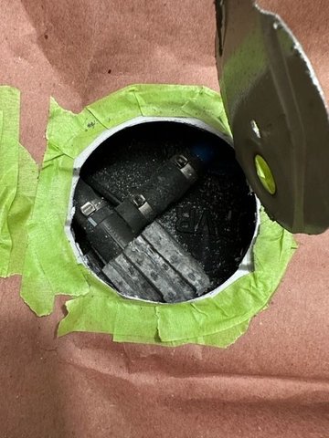

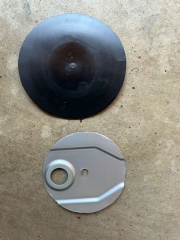

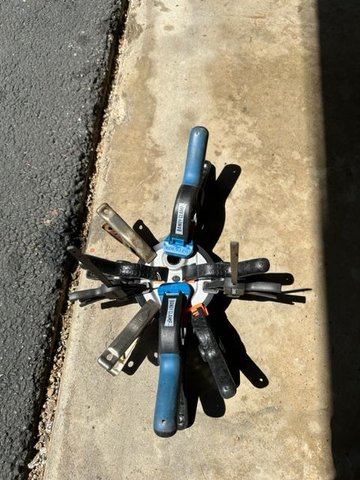

Thumbs up Reversed my decision and decided to drill hole instead
This post is to conclude my journey of figured out and resolved my fuel filling problem.
As the title indicated, I decided to cut the hole instead of spending at least a few days to drop the tank to reconnect the wires and reinstall everything.
What I was concerned were that if I drop the suspension and the fuel tank, I may encounter problems along the way to open or put it back together and therefore went with the safer method.
Here is what I did.
1. Cover the front trunk and tape around the area to be cut. Using a 4-in hole saw arbor kit and a power drill, drilled the hole slowly to preserve the aluminum piece.

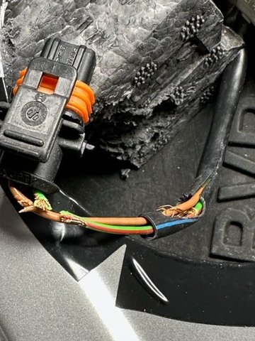

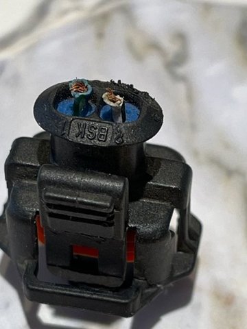

2. After opened up the hole, you can see the fuel tank vent valve (996-605-203-01) right under and cover by a grey styrofoam.
For my problem, the CCTV that I did identified broken wires that need to be reconnected, with the help of curve plier (it took some time) I was able to unplug the wiring connection (a little challenging because it is all the against the wall way inside to the left looking from the front of the car). You can see clearly the wiring have been chewed up by mouses.
3. Reconnect all wires and drive to a gas station to check if this is indeed the problem.
!!! Gas flow in and no more pump kick back and spill gasoline all over the filler neck.
4. I cut a 4.5 in black plastic that I have and glue it to the back of the aluminum piece that was cut off. This would allow 1/2 inch under as a base to glue it back to the car.
Make sure that the plastic is a little flexible so that you can insert back into the hole by cutting 1/2 inch of the plastic to slide in.
5. I use automotive Goop to glue the plastic piece to the cut aluminum and seal around the cut piece/plastic/surrounding. I then use silver touch up paint to blend in to the surrounding. Job finish. Total time 2 hours (excluding time to wait for the glue to dry).
The "Pro" of using this method is it will provide an access point to replace fuel tank vent valve in the future should it go bad without requiring to drop the tank (a lot of labor).
The "Con" cutting the hole of a Porsche 996TT (in my case all stock and in excellent condition).
I hope by documenting my journey of solving my fuel filling problem, it would give somebody in the future some ideas of the approach they may want to take to solve their problems.
Thank you 6speedonline's community of providing me with ideas and as a result, help me resolve my problem.
