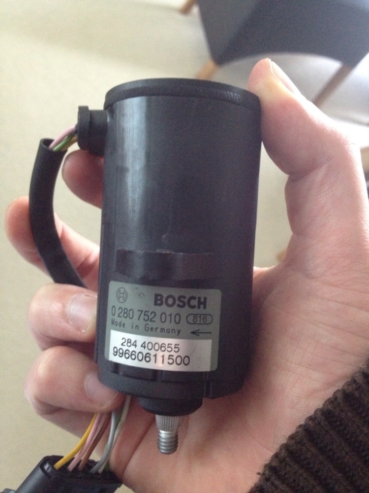

Just to wrap this thread up (for future searches out there) the culprit was the throttle poteniometer:
Worth mentioning this part is shared with the 986 Boxter range. 3 Bolts and unclipping the connector is all it took
Thanks for all the help!
