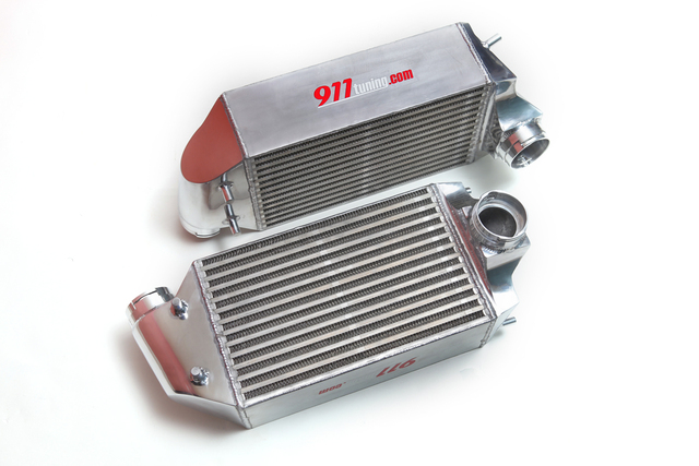

Same thing happened to me when I upgraded to the GT2RS ICs. I put in one of the C clips on backwards and it the hose popped and started leaking. The interesting part was that when I plugged it back in, the car had a tendency to overboost since the ECU had tried to compensate for the boost leak and kept requesting more boost. I had to disconnect the battery to for a few minutes and that reset everything back to normal. Just give the hoses a good tug and wiggle to make sure everything clipped in correctly...
How are you liking the GT2RS's? I just acquired a set and plan to do the install soon.
Old Feb 13, 2013 | 01:44 PM
pwdrhound's Avatar
Joined: Jul 2010
Posts: 4,848
Rep Power: 457
Thermal recovery is great on the track for prolonged sessions where the power stayed constant while the regular coolers would heatsoak after 5 minutes of hard running. I don't think you'll be able tell any difference on the street with short bursts of full power. I couldn't.... I think flow rate is probably similar for both...
