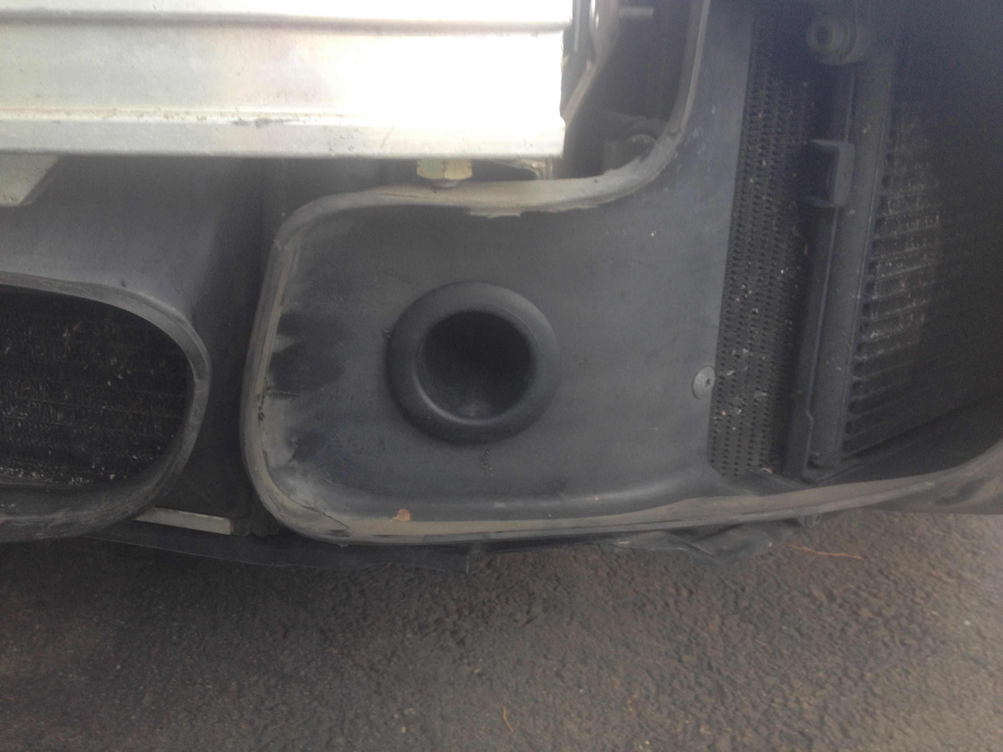

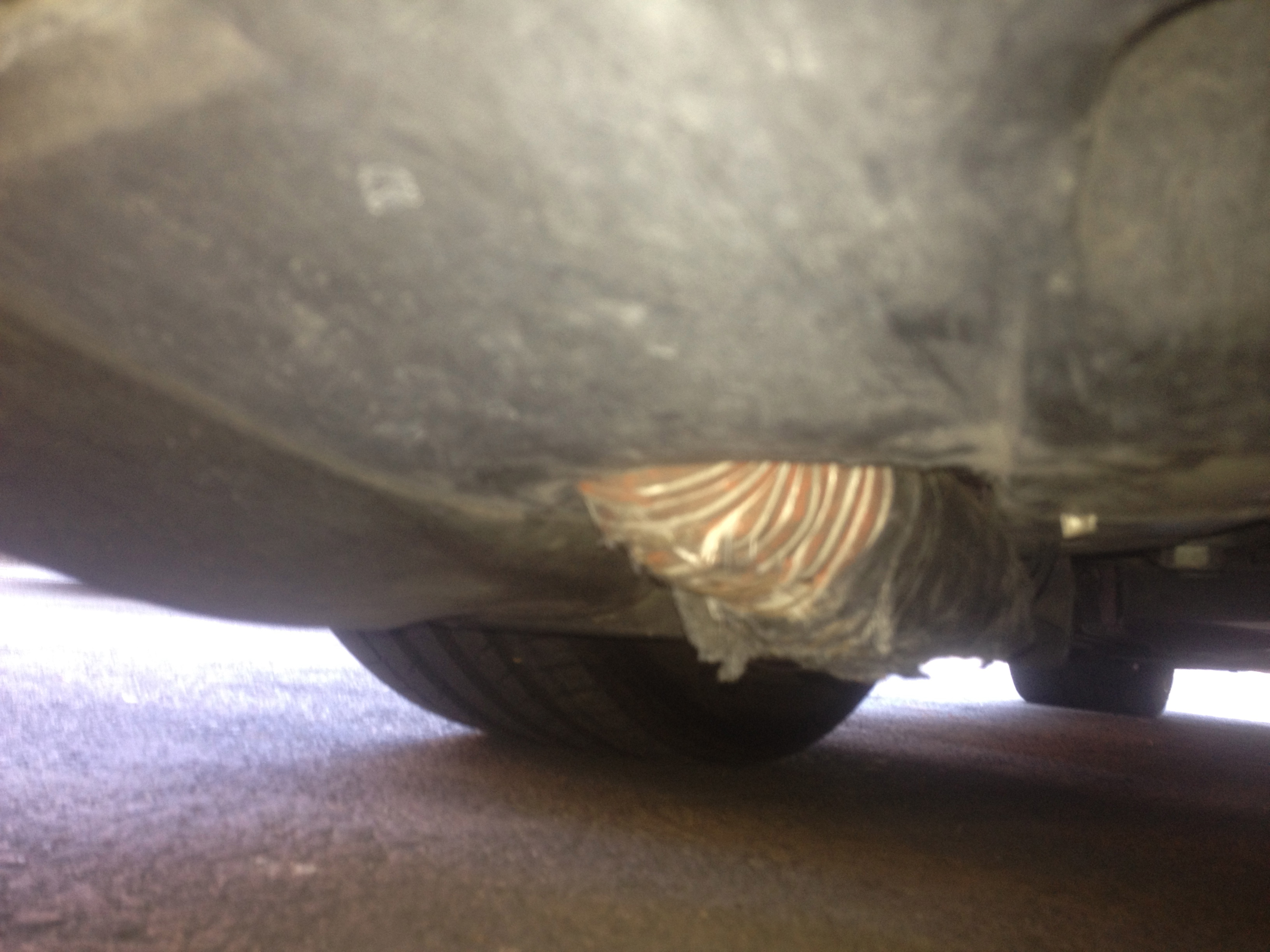

bumper off.. thought i'd share another customized option
ID:	273901   Click image for larger version
