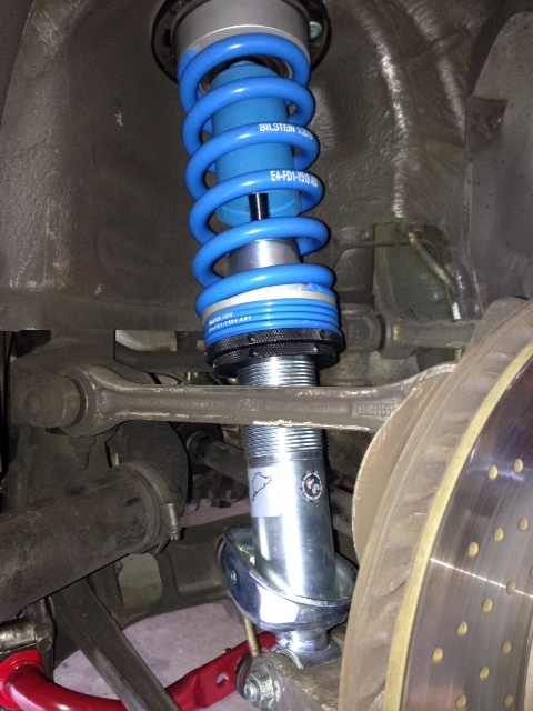

I've attached pics of my install. You can see how I've adjusted these. BTW - they did settle a bit (maybe 1/4 inch) over a couple of days and driving.

The 10's sit much lower than the 9's. Don't mind the rusts, its from washing the car.

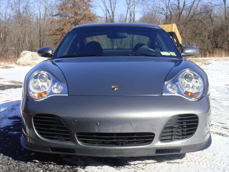

I am the one who sold you these PSS10s and I had them on my 2003 996TT. I had them professionally installed, and eventually replaced them with Motons given that I track the car a lot now, the ride height was noticibly lower than stock, both in the front and the rear.
Here are a few photos of my car with these PSS10s installed on my car.
