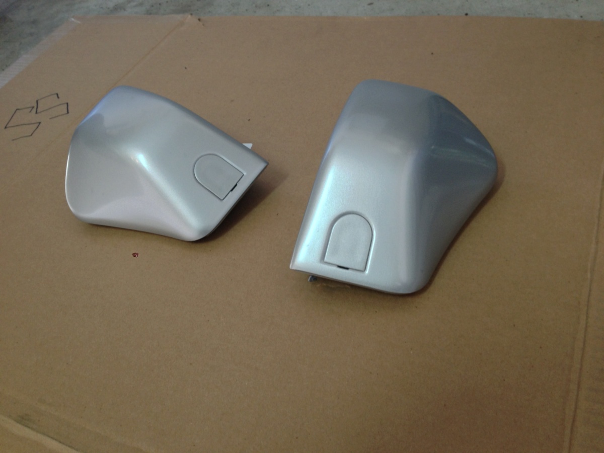

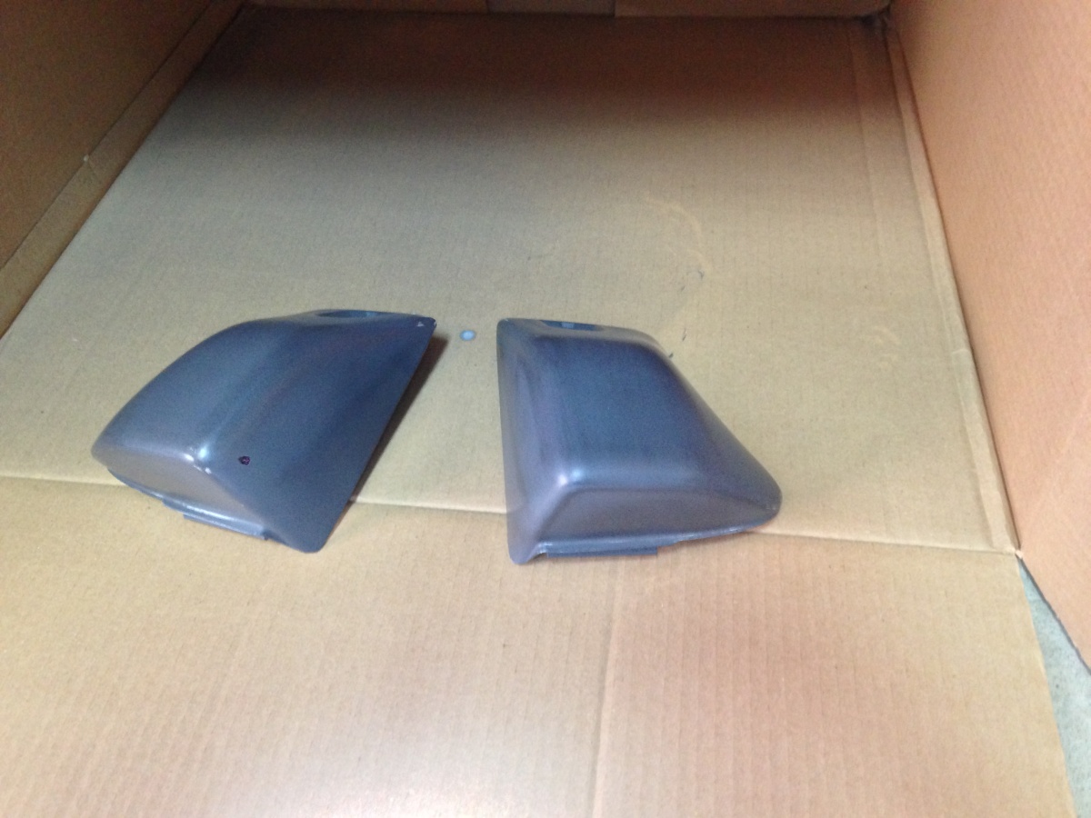

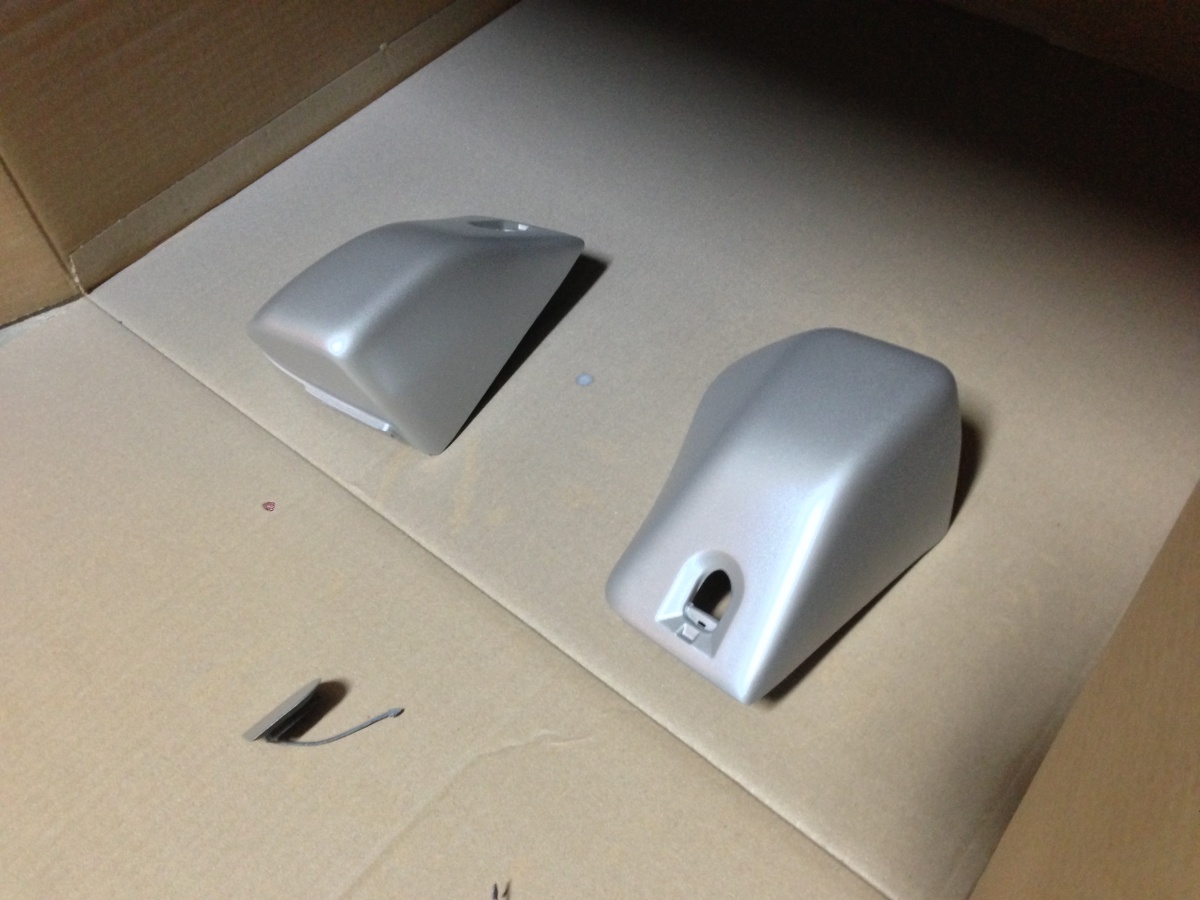

So I decided to try my hand painting my bumperettes, the overall process wasn't too hard but was time consuming. The end results came out well, just need to take your time.
1) Sand down the finish with 120grit to get rid of the pebble finish.
2) Primer with high solids or high hiding primer, 2-3 coats. Sand with 600.
3) Primer with normal sandable primer. Sand with 600 grit again. Don't go too far and rub through to the original finish.
4) Paint with color of your choice, 3 coats. I ordered a 16oz spray can from an online site. Was way more than enough to cover.
5) Clear coat, 5 layers 15 mins apart. Two choices here, Enamel or Lacquer. People are split on what to use. Enamel is harder but less flexible, since the bumperettes are flexible I used Lacquer which is less prone to cracking I'm told. Start with a light layer, then spray more with each coat. Don't get too crazy or it will run. Let cure for 48 hours.
6) Wet sand with 2000grit using water and soap. Let sand paper soak in water for 10 mins before sanding, help keep hard edges from accidently scratching. Will remove orange peel (where clear coat looks like surface of an orange) and smooth out nicely.
7) Polish with a compound to bring back shine. Parts will be dull looking after wet sanding. Compound will make them super shiny again.
8) Wait 1 week before waxing. Paint and clear is still off gassing for 7 days, do not wax until after that time. You can install before waxing, no big deal once clear is cured.

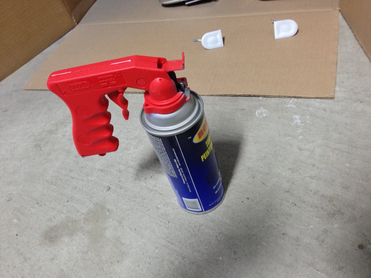

Cost about $70 in paint and supplies to do, was very easy. Just take your time and don't get too excited with paint in any one coat. Much better off to spray multiple light coats. I bought a paint can handle to paint with (pic 3) makes painting with cans so much easier and highly recommended. Running paint or clear is bad bad bad...

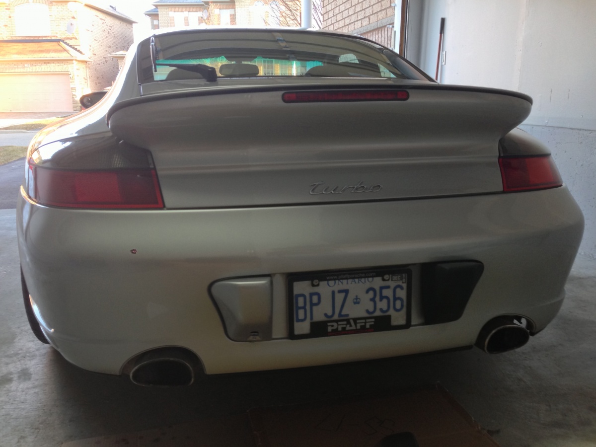

And a few shots of them on the car. Color matches perfectly and looks how the car should have came
