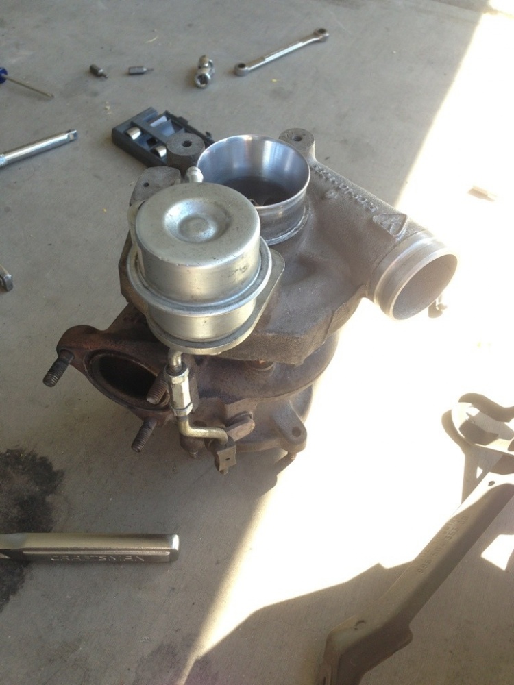

Help identifying these turbos.
Old May 12, 2013 | 01:14 PM
dhahlen's Avatar
Joined: Jul 2011
Posts: 1,958
From: Arizona
Rep Power: 166
dhahlen Is a GOD !dhahlen Is a GOD !dhahlen Is a GOD !dhahlen Is a GOD !dhahlen Is a GOD !dhahlen Is a GOD !dhahlen Is a GOD !dhahlen Is a GOD !dhahlen Is a GOD !dhahlen Is a GOD !dhahlen Is a GOD !

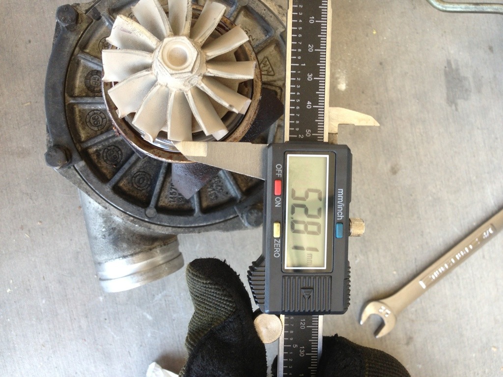

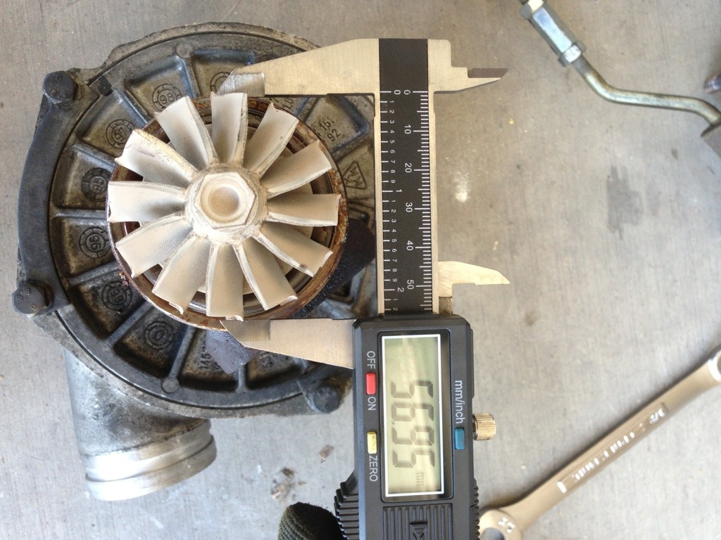

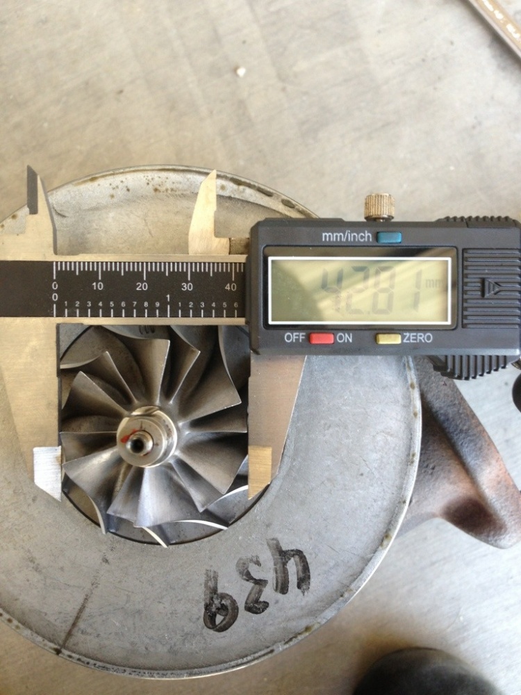

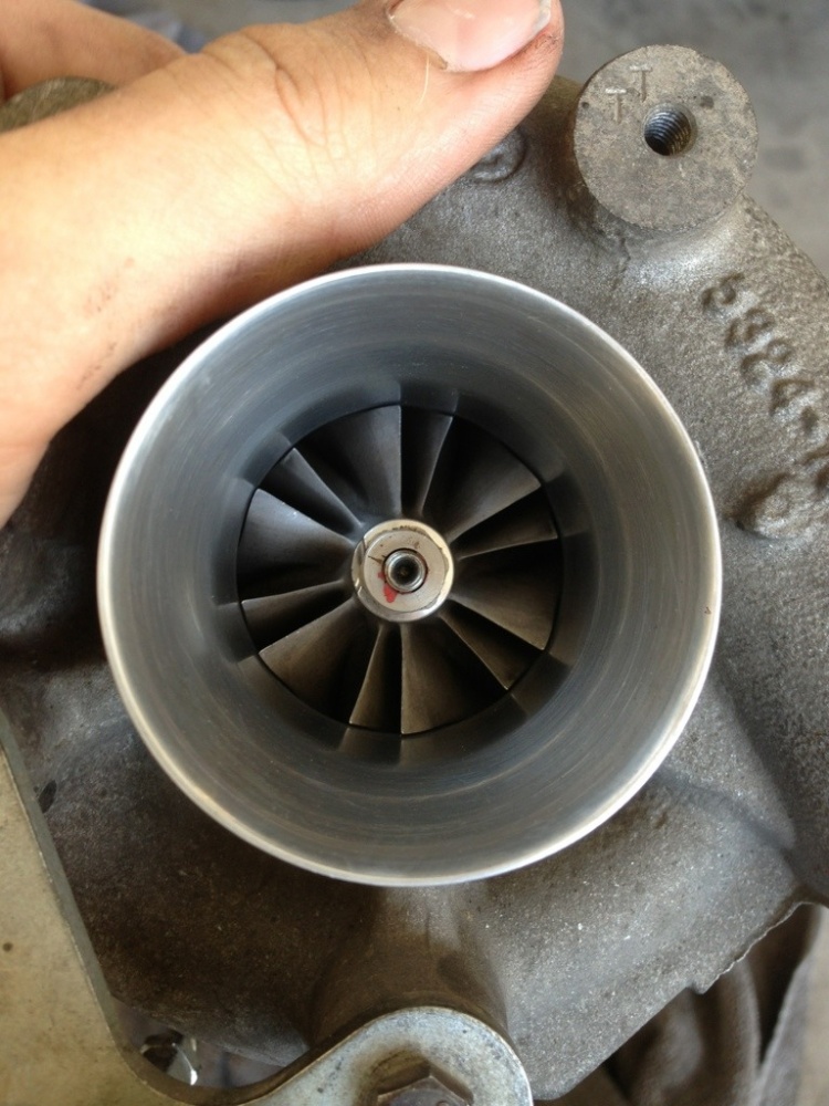

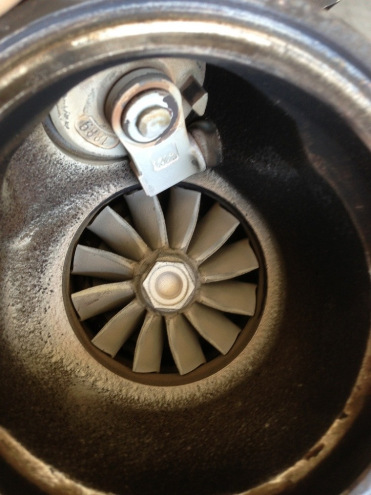

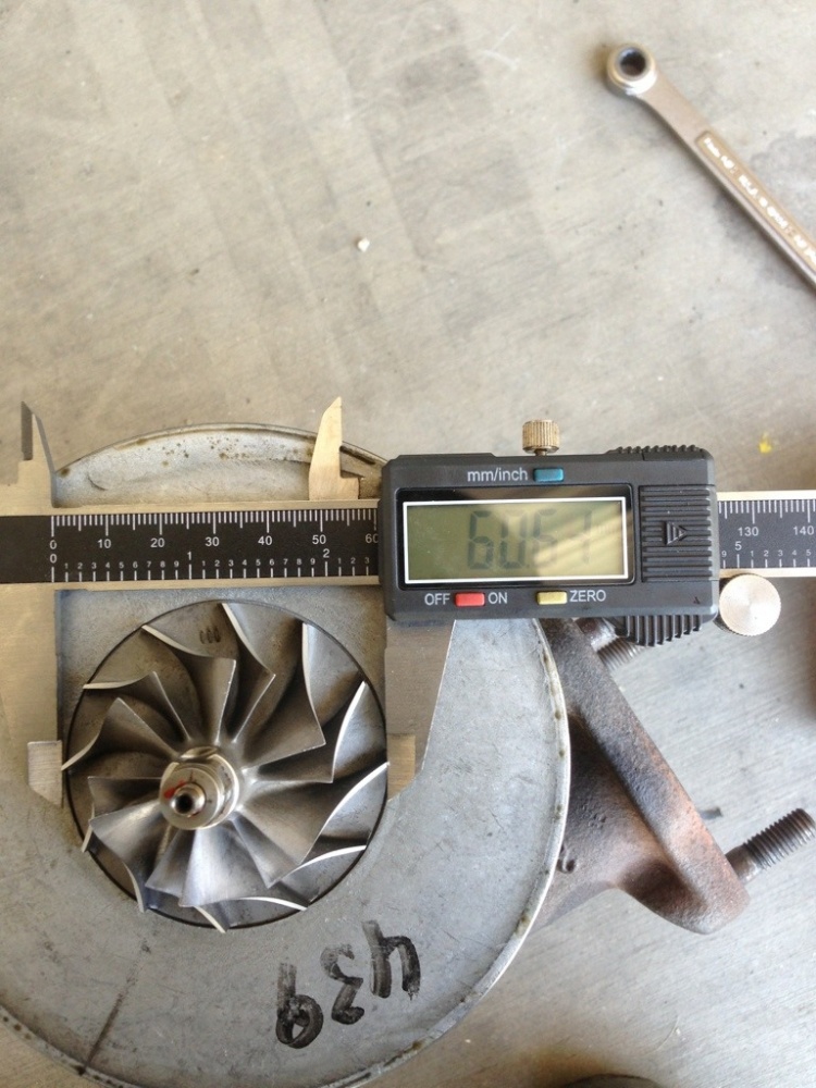

The exhaust wheel looks like it's approximately 48-50mm. The IN/OD for the compressor wheel are shown in the pictures.
Possibly a K16/24 hybrid?
Thanks!

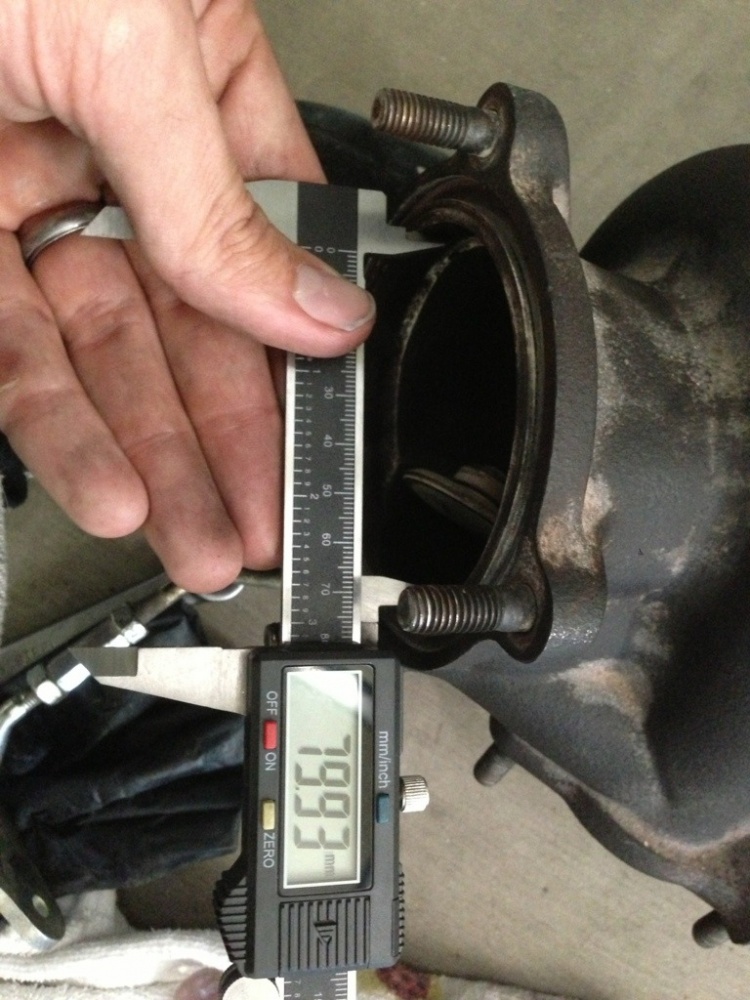

Hey can you measure the ID of the exhaust outlet... Thanks

HI,,If possible, the measurement size. Thanks..

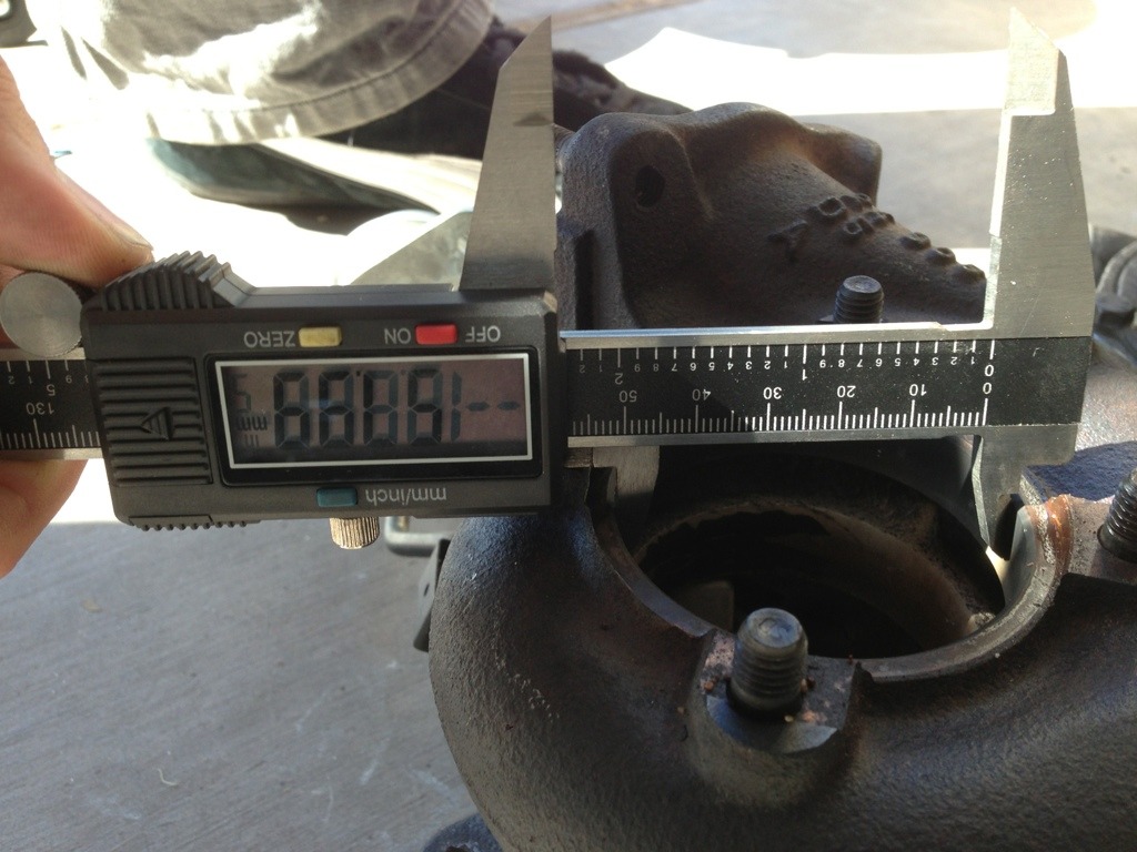

outlet on the exhaust housing is 58mm
HI,,Thanks but that doesn't sound right for the Exhaust ID output size of the turbo that the exhaust bolts to?,,
That sounds more like the intake inlet side size of the turbo...

Sorry my mistake ,should have made it clearer...That's probably the exhaust header side ID....

hard to read, but gauge says 57.99mm
Here is the output...
80mm

The reason I asked is because ,as I posted in the past, most exhaust cats and cat delete pipes have a 2.850 opening so they are smaller then the turbo exhaust outlet of that 80mm size,3.150 opening, that you verified..

It looks like an 18g compressor wheel ?
And it does have the bigger exhaust housing outlet..

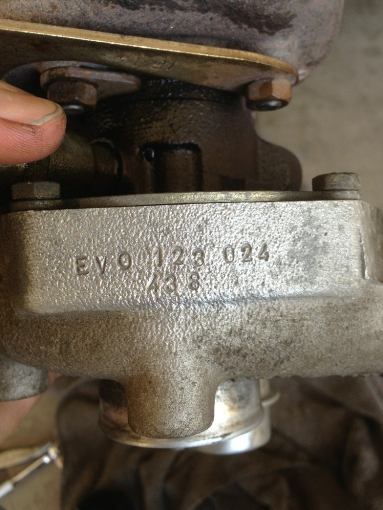

Looks like a K24/18g wheel with a K16 hotside?

That hotside looks either clipped or a K24, not a standard K16 hotside. The compressor is definitely not an 18g, the measurements and blade configuration would indicate it's a BW 2470 (the common "K24" compressor wheel). My guess is its a standard K24 turbo all around -did you have info that would lead you to believe it's a hybrid?
Old May 12, 2013 | 10:32 PM
SamboTT@ByDesign's Avatar
Joined: Sep 2003
Posts: 4,901
From: L.A.
+1
That's a K24 with a polished compressor housing and upgraded WG's. Looks like how my guy Turbo Bob here used to do them.
