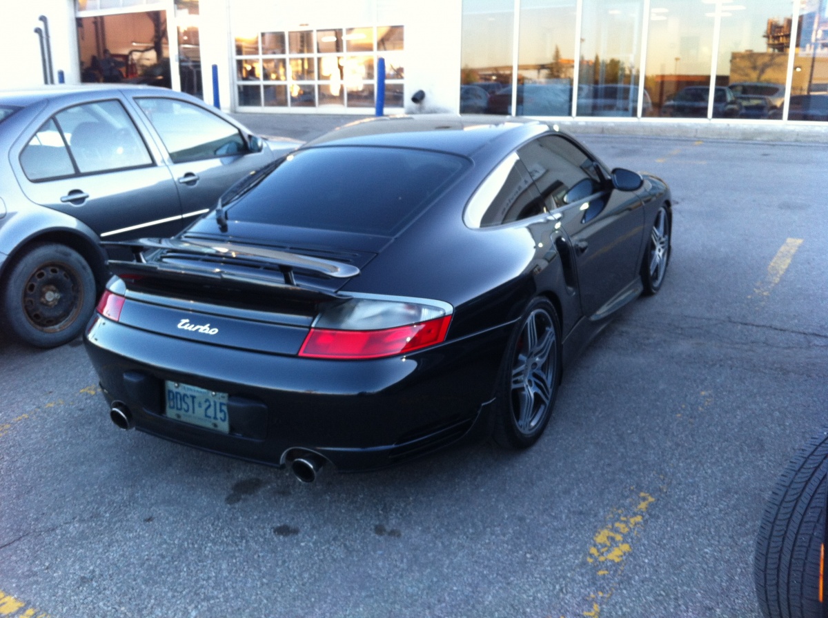

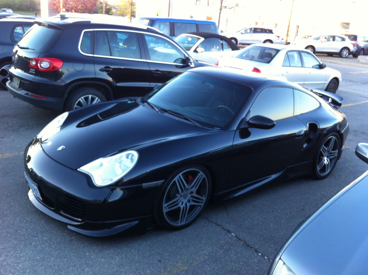

PSS 305/30/19 I have this on my car on 11" 997 wheels and they look bulged out. I think a 12" would make them fit almost flush and look good.
