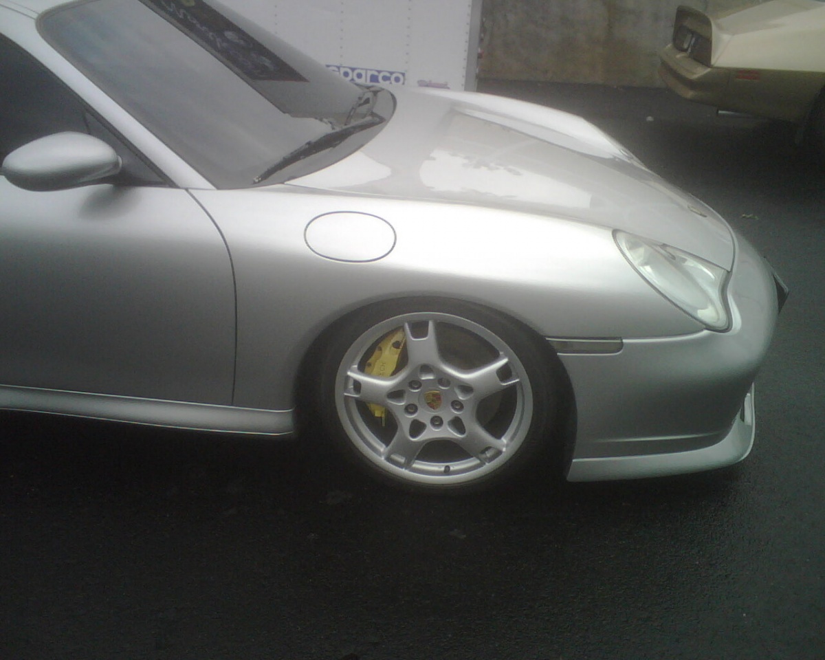

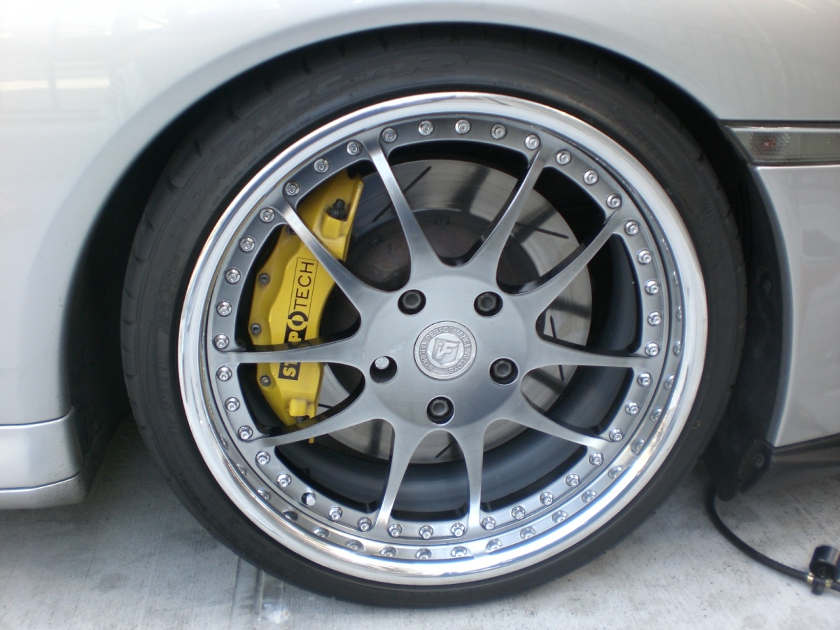

take some pics for us. it may just LOOK too low because its sitting tucked under the fender.
here's an example.
these are 3 different wheels on my old 996 at the exact same ride height. looks can be deceiving.
do you notice how the 997 wheels make the car look so much lower because theyre tucked into the fender... 997's have a wider track, so they'll have a higher offset.. so you have to run spacers if running 997 wheels on a 996.
