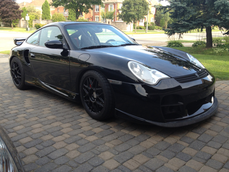

The car now has a M.1000
fully built 3.8 motor
GT3 cams
GT3 ported heads and a Stock 996 Intake ported to match the heads
HTA3586 turbos
Markski - headers, Intercoolers, and 3" exhaust

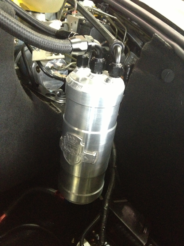

E85 fuel system and fuel set up- ID2000's, twin 044 in-tanks feeding a Surge tank and a Weldon delivering the fuel to the Motor.
Trans with rebuilt with a Guard 3 piece main shaft with the following gears 1st-3.154(13:41) 2nd 2.375(16:38) 3/4 1.750(20:35) 5/6 1.308(26:34)
Guard also made up a LSD for the car so it tracks straight.
Installed 18" HRE R40 rims to keep the rating mass down.
DSS axles in the rear - RWD conversion.
Red top Optima battery - installing my carbon Braille for the event day.

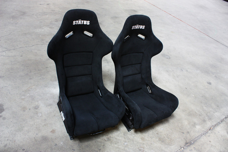

installing the Status carbon seats to replace the Sport seats.

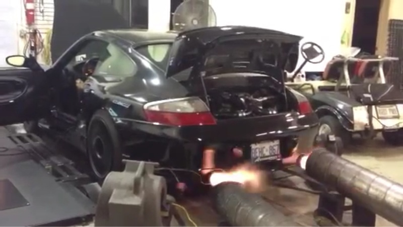

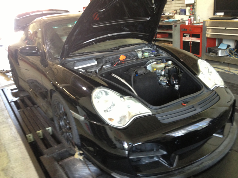

Car made 881 at 23psi on the Dyno not looking to break dyno numbers in any sense just a very good conservative tune.

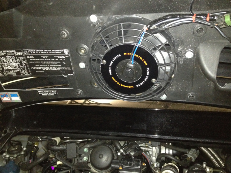

Finally got a new fan!! Need to cool this beast down

Interesting to see the fan. What are specs? higher CFM than stock?
