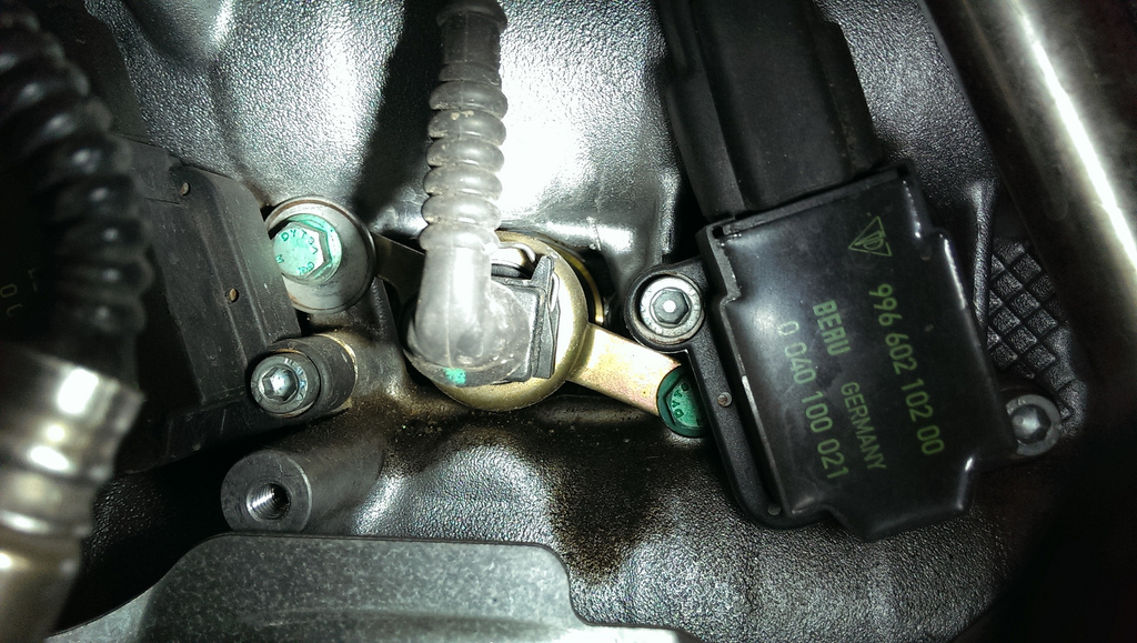

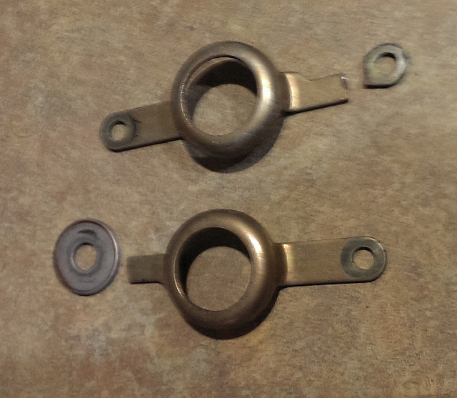

So I took the weekend to change the plugs and coils on my car, and thought "while I was in there" I'd pre-order the valve lift solenoid brackets (or whatever the heck they're officially called) juuuust in case one of them was broken.
So I get crackin...
And notice something on the passenger side that doesn't look quite right.
I suppose that counts as a shadetree 'fix'. Guess I'll need one of these bad boys afterall.
Long story short, here's what I ended up with:
2 for 2.
Car is an '02 with ~54k miles. Just reaplced some worn motor mounts, no idea if the old ones contributed. If anyone's going to be doing coils/plugs any time soon, go ahead and order the brackets!
Also, I guess the last person in there to fix the problem went ahead and did the spark plug change. Plugs had no electrode wear, although I'm not sure what old bosch twin tip plugs actually look like. Coils looked great too, but they were the 996 pn. Anyone want some used, but not very used coils and plugs? If it wasn't so much damn work I would have left them in there!

also, the coil closest to the wheel on the passenger side had one of its hex screws stripped >:I more like 700 lb/ft vs the 7 or whatever it should be. Talk about a pain in the *** to remove!

Good catch! I'm surprise about the bigger washer used (probably by the previous owner) to hold the broken bracket in place..This bracket is only $16.44???? Good job zmt!
I can see it being done by an individual that already had the car taken apart and couldn't wait to get the parts in (assuming they wouldn't go to a dealer). I'm also guessing though that it wasn't enough to keep the solenoid 100% seated, since I was smelling some burning oil occasionally and from what I saw when I pulled out the solenoid the oil that comes out sure does like to find its way to the headers.

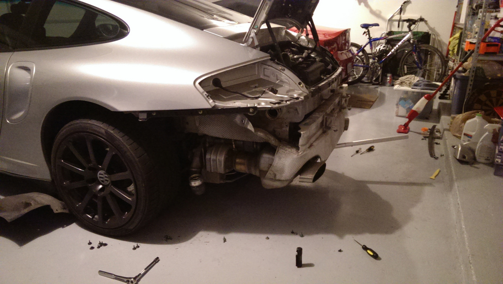

So did you jack the car up, take the wheels off, remove the bumper, then put the wheels back on and set it down? Just trying to figure out how you got the rear bumper and fender linings off with the wheel still there, it's damn tight. Unless you just like to limit your work space lol.

Just a clever use of tools. I had a T25 bit inside a 1/4" socket on one of those finger socket wrench things. With the suspension drop from the car being jacked up I didn't find any reason to remove the wheels. Plus I have some weird thing where I can't remove the wheels by hand anymore now that I have air tools and I wasn't about to fire up the compressor

What's causing these things to fail? They metal, bolted in and can't flex. Weird...
Old Mar 24, 2014 | 12:33 PM
zmt's Avatar
zmt
Joined: Jul 2013
Posts: 111
From: DFW
zmt is infamous around these parts
casting/molding defect combined with heat+vibration over time? All the ones I've seen have broken in the same place (where the arm of the bracket meets the enlarged/flared bolt hole). The arm with the straight hole never seems to break. maybe the hole is slightly off center and the vibrations impart some kind of torque on that arm? Who knows? Buy a few to keep in the tool box!
