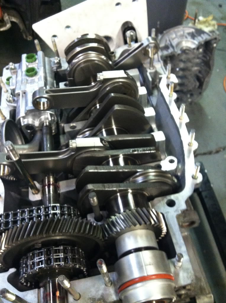

What are you going to knife edge?
That is the turbo crank. DO NOT TOUCH IT. I make 1300 to the wheels. no issues as yet.

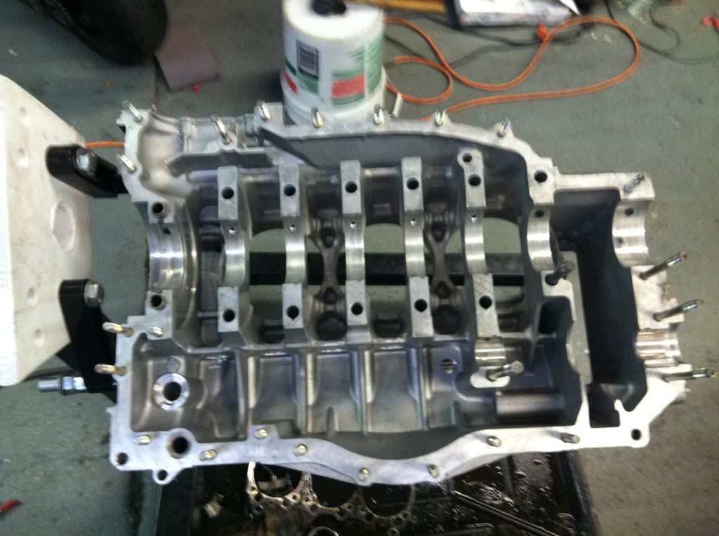

John,
The web that follows the bottom of the main caps is sorta a wiper.

Tim,
I though your recent pic (bottom) would make a somewhat similar comparison. Very nice work. Looking at the previous post .... is the case shuffle pinned?
Knife edging, with 1300 hp what's another 8? It's pretty much known that as you squeeze the last bit of power out it gets extremely expensive. It ranks up there with the costs of pulling a 12-15 HG case vacuum or boat tailing to extract 15-20 ponies. The builds appear to be similar and different in many ways. From listening and I could have listened wrong, your build is for quarter mile and mile fun. Our build is for the track. Very quick response over a wide rpm range. It was not designed and will never be used for off the line.
Thanks for sharing.
