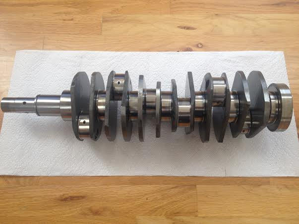

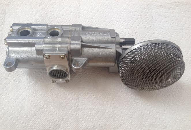

Well, I started acquiring parts for the rebuild. Just received a GT3RSR crankshaft and dual pick up oil pump. Rods and 3.8 pistons/liners to go..
ID:	336310   Click image for larger version

Originally Posted by vr4henry
whoa... I like that, John!!
Thanks Henry. It was a deal a couldn't refuse. Came out of a 2007RS with 8000 miles. The owner is building a 4.2L and completely stripped the motor down and is parting it out. New crank, pump, pistons, cams, etc..

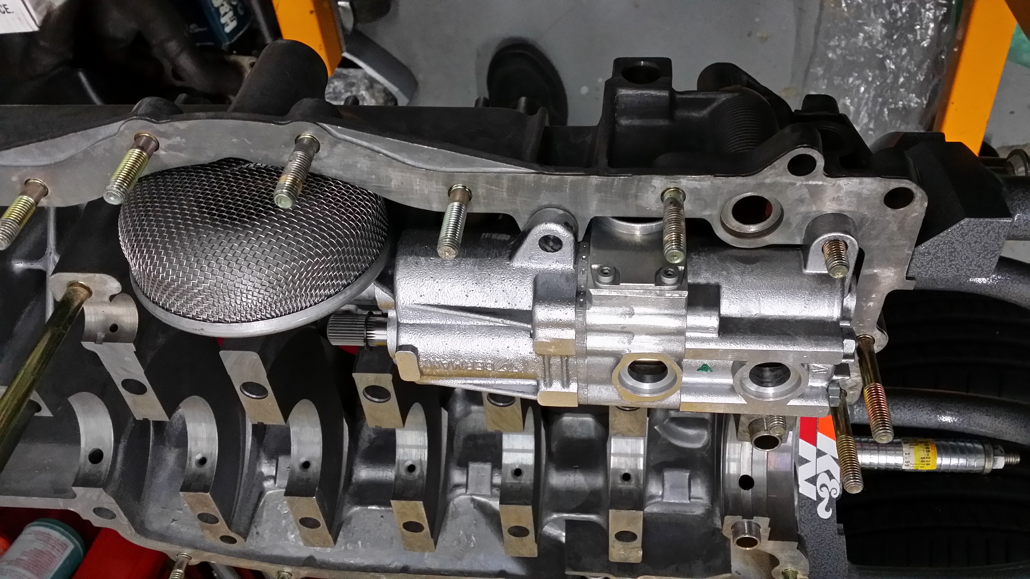

i also have this rsr part for the rebuild. love it
