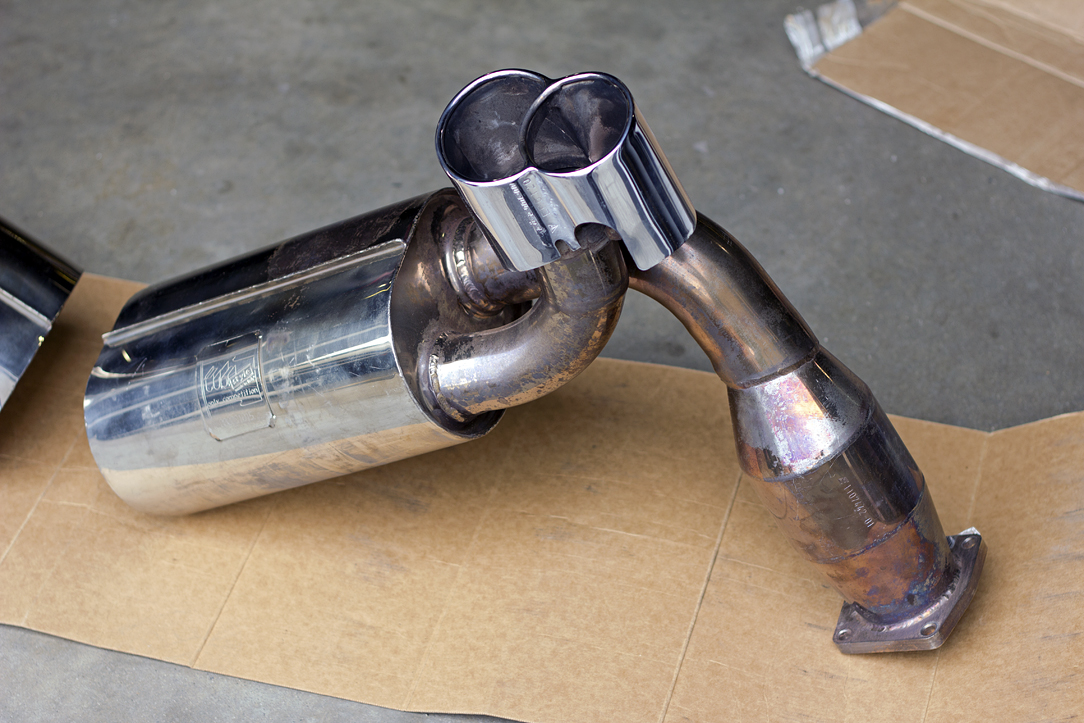

Tubi Exhaust (catted)

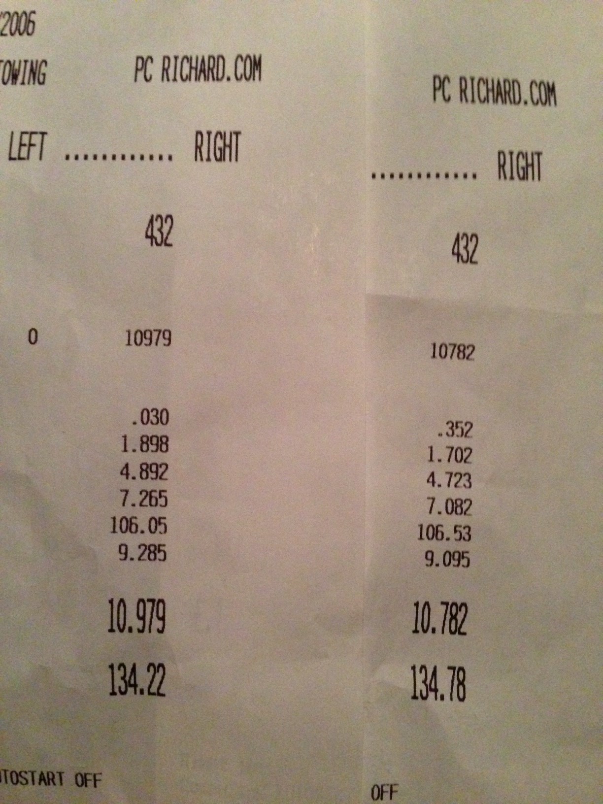

Picture of the slips attached...

Added MS109 on completely empty tank at the track.
Boost was about 1.4 bar that night.
Car is 130+ mph on pump too (at about 1.25-1.3 bar), which was my original goal....but we all know that a goal is simply a "moving target"

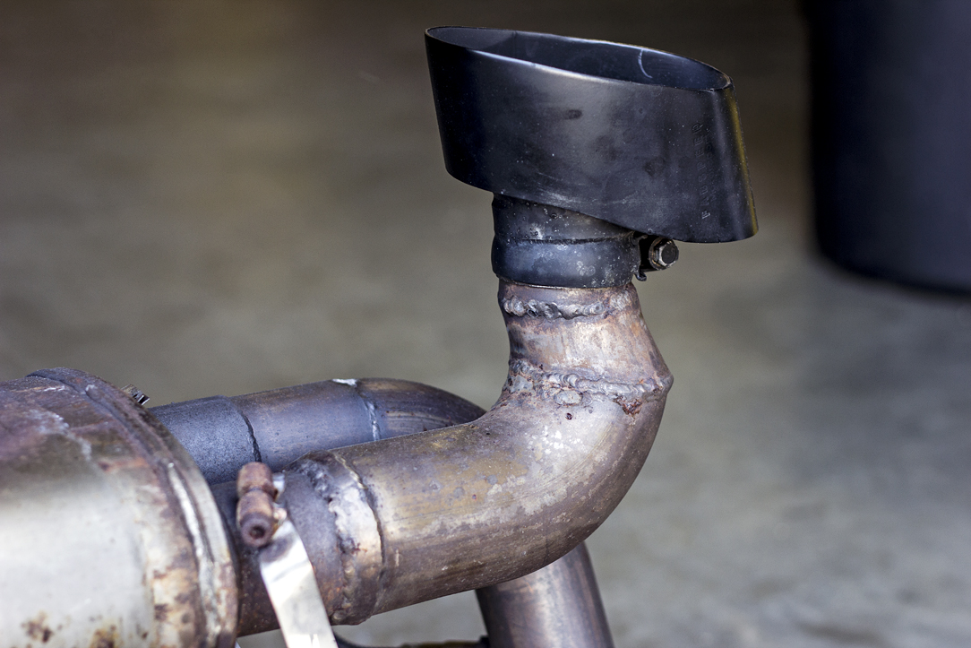

You should've seen what was on there before...
Makes me still want to hurl
