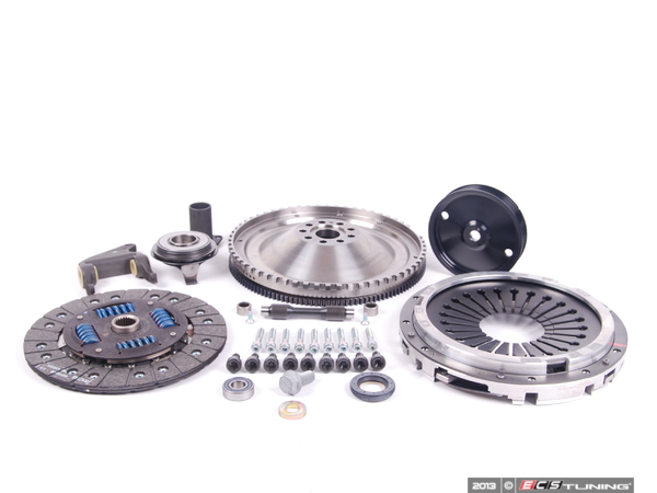

Sachs makes the stock clutch. I'm not positive on HP numbers, but If I was going to upgrade I think I would go with the 996 GT3 RS Light Weight Flywheel Conversion Kit. For more information Click Here.
Very well put together package! price is good too. One thing the crank pulley is also a under drive unit besides being lighter.
which disc material does this kit use?
I'm about to put in a similar kit except I'm going with the improved 997GT3RS 4.0/GT2RS clutch disc instead of the older design 964RS disc. Porsche made improvements to the springs and rivets on the new disc and it should be more durable and a bit quieter than the 964 disc. I'm also using the 764 Sachs Motorsport pressure plate instead of the 996GT3 PP. The 764 has the highest clamp force of any of the Sachs Pressure plates and is a better fit for a torque rich Turbo car.
Organic/kevlar/fiber tuff ?
The clutch disc in the kit comes from Porsche, and I believe it uses an organic friction material.
