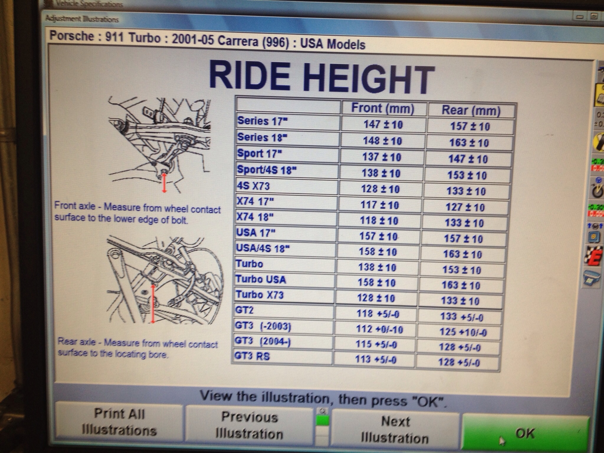

It doesn't look all that low. Measure it from the factory measurement points. I think it's a bolt head in the front subframe and a flat machined spot on the rear. Then there is a chart floating around with all the factory ride heights (996, turbo, x73, gt3, etc) that you can compare to.

996 ride heights
Attached image might shed some light on the topic. . .

The PSS9 kits have a very small height adjustment range clearly spelled out in the installation instructions, 5-10mm. Do not go lower to avoid bumps stop issues... Many people disregard this and then wonder why their car is handling funny.
