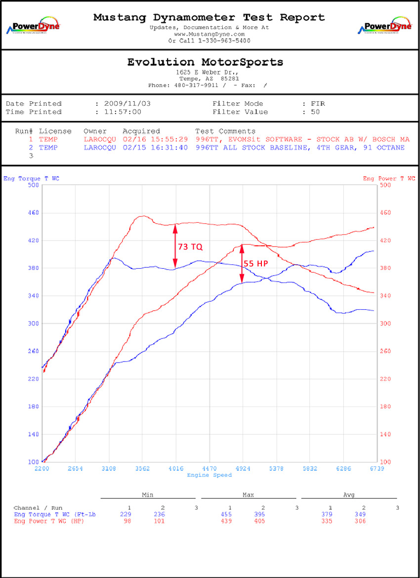

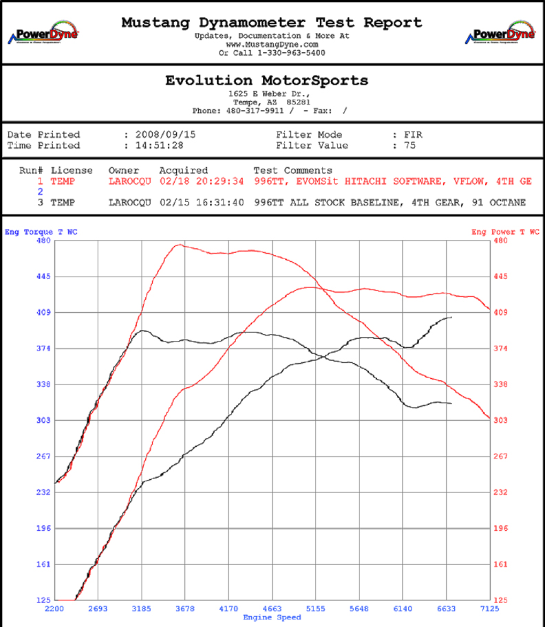

There's a lot of heresay and mis-information floating around in this thread about our intake, so time to clear that up.
First off, our intake is very safe to use as far as water ingestion, using a similar design and fresh air inlet location as the stock airbox if that is any benchmark. There should be two holes in the bottom of the airbox for water drainage that work quite effectively. In my previous life working at a shop in MN, I kept an eye on many 996TTs with this intake that had been started after sitting outside all day in torrential downpours, driven on the street or on the track in torrential downpours, had different wings on them, had 6"+ snow sitting on them, and have never seen a significant amount of water pooling in the airbox that would ever cause a concern.
Secondly is the MAF concern. Our intake uses a proprietary venturi and oil-free air filter. The goals were to allow a very high level of airflow while maintaining very consistent MAF readings. The venturi allows this, as it lets us go from a large filter opening to the OEM MAF housing diameter in a short distance while maintaining laminar airflow. Laminar air flow = consistent, accurate MAF readings. The consequence is the air speeds are elevated, which kills Bosch MAFs when running at tuned power levels.
The solution to this was to develop the Hitachi MAF conversion, which includes the sensor, a new MAF housing, and new software designed to read the sensor properly. The Hitachi MAF sensor is much, much more reliable at higher power levels than the Bosch is. We utilize our standard V-Flow Hitachi intake up to 900hp before going MAF-less, if that's any indication of it's power and metering capabilities.
Regardless of MAF sensor, the intake should use our oil-free Synthamax air filter. It's reuseable similar to a K&N, but does not use oil. Despite being labelled 'DO NOT OIL' on the end, I have seen people oil the filter which can cause issues right away. If this happens, the filter needs to be replaced. We also offer an intake sock that goes over the filter to help in very dirty environments.
The intake does provide worthwhile power gains, about 15-20ft-lb and 20hp throughout the midrange on a Stage 1 or 2 car when paired with our software as seen here:
Stock vs. EVOMSit Software, stock airbox
Stock vs. EVOMSit Software, EVOMS V-Flow w/ Hitachi Conversion
Our intake does not suck in hot air or water. It is not an under-sized cone filter clamped onto a tube giving inaccurate MAF readings. It does not make less power than stock. We only sell these because they make cars go faster and they're a reliable product. We specifically DO NOT recommend aftermarket intakes on the 997TT and 997 GT3 models because we haven't developed or seen another aftermarket setup that works as well as stock, even up to huge power levels, if that's any indication of our integrity on this subject.
