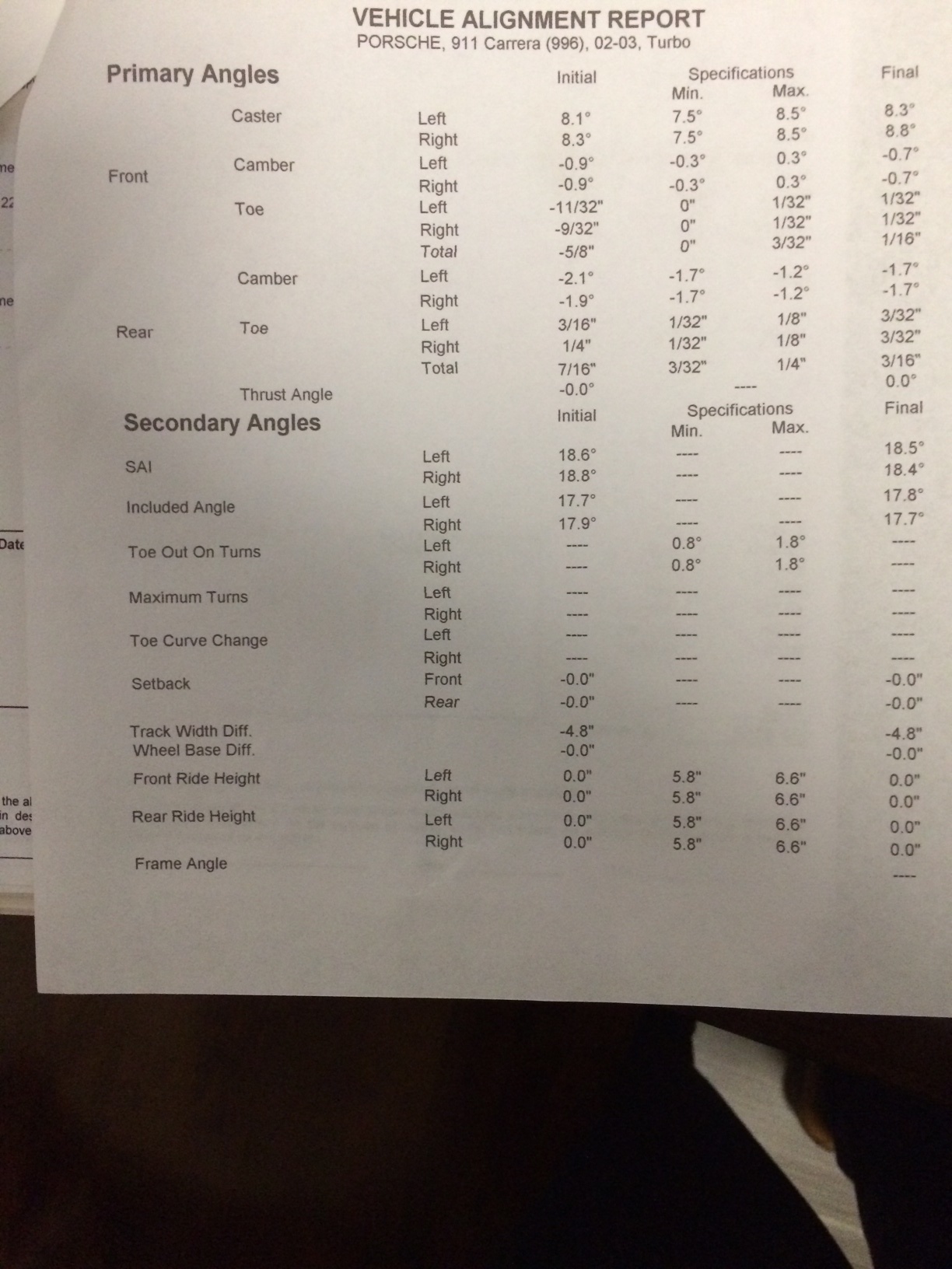

I am trying to resolve excessive inside wear on my rear tires. I put on PS2s (315/25/19, sitting on H&R coil overs, at a a "one-finger" gap) about 2k miles ago and they are pretty worn out in comparison to the rest of the tire. I did some searching and some recommend dog bones and/or control arms, some didn't; case by case. I got an actual alignment when I got these tires (2k miles ago), and here are the readings.
If raising the car higher will solve most of this wear, how high do I need to go? Dog bones or control arms? Can someone help me pin point what actions I need to take to correct my inner tire wear? Thanks!

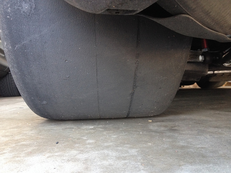

Neither. It's your toe. Incorrect toe will eat the inside 1" or so of the tire. Look how much toe you had prior to the alignment! Too much camber will wear the inside of the tire but it will be more gradually across the whole tire tread. Here is a picture of my rears with -2.25deg camber and toe set at 0.17' per side, 0.34 total. Tread is totally gone but wear is even. Installing solid thrust arm bushing in the rear LCAs HELPS A TON with tire wear as it helps lock down your toe settings. You'd be surprised how much your toe moves around under braking and acceleration with the rubber bushings compressing. When you accelerate, you can get as much as an extra 1/4" of toe as the bushings compress. Same under braking. All this tears up the inside of the rears. I know people, especially those that have spent the money on them, will disagree, but dog bones are a waste of money for the most part. I tried dog bones, hated them and ended up going back to the stock pieces. Even 996 Cups use the stock parts sans monoball. Unless you are low rider slammed, your camber eccentrics should get you in the ballpark of -2.0 camber or less.

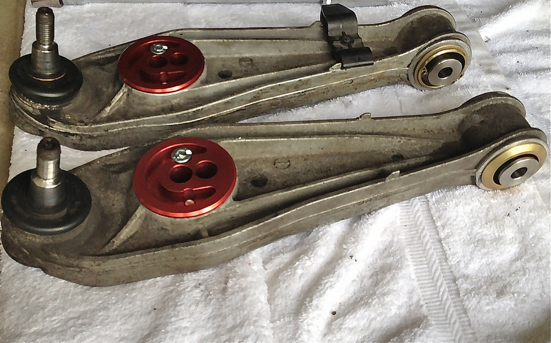

I like the Tarett thrust arm bushings because on the adjustable ones they are the only company to use two securing bolts which prevent slippage. Most other companies only use one bolt. For the rear, you only need the non-adjustable ones which are cheaper. The Tarett toe arms are a good product. No fluff, they just work. Reasonably priced, track proven. Yes, all these parts work with the stock LCAs. You simply press the factory rubber thrust arm bushing out and install the solid one (you do have to remove the LCA from the car to press the bushing out).
Here is a pic of the rear OEM LCAs with the Tarett adjustable bushings. In this case, monoballs were also installed. The car already had toe arms but just adding these two components drastically improved rear tire wear in addition to getting rid of some of the squirliness the car had in the rear. All a function of locking down the rear end... PM me if you have any questions..
