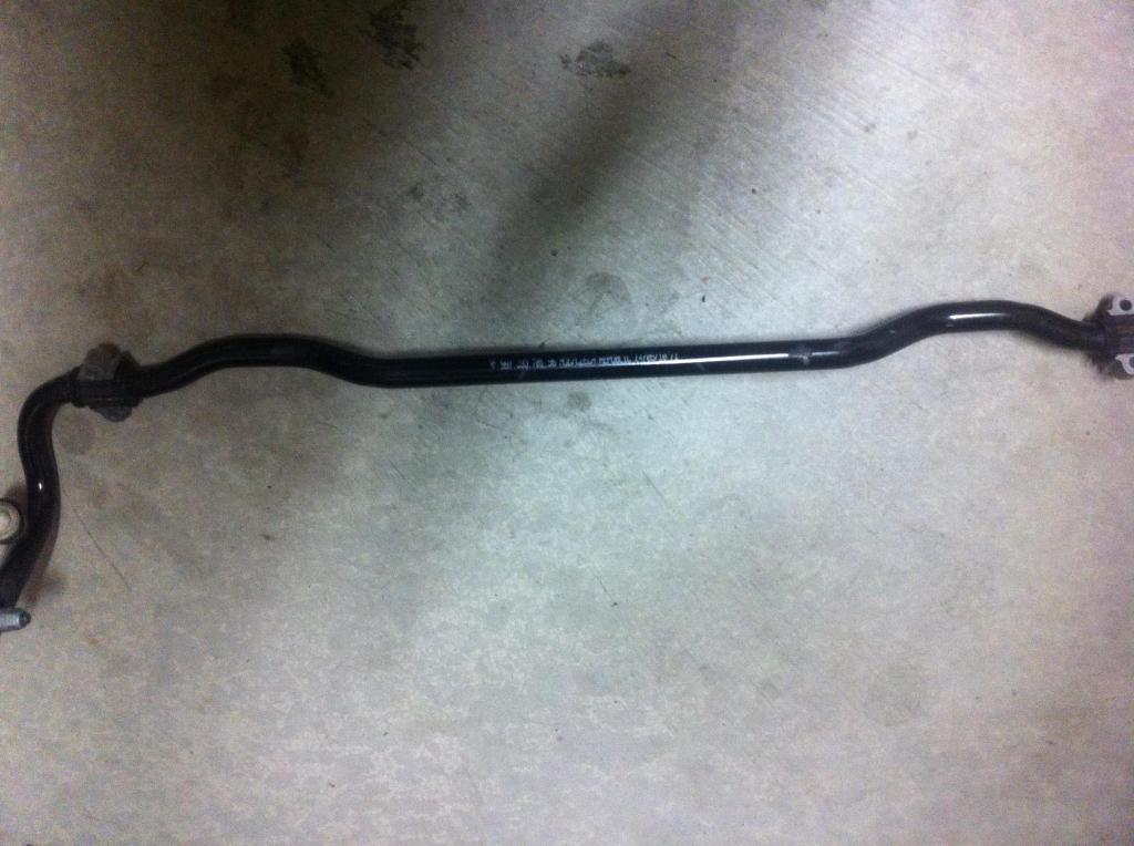

Hi guys I need some help. I dropped off a GT3 sway bar to be installed with the Tarett droplinks and just got a call that the bar will not fit, something to the effect that it hits the control arm and pinches between the transmission and subframe??
Any insight is appreciated.

Early 01's are different then the late 01' - 05'. Is the flat aluminum cross bar straight or does it have a kick in it?

Is that the stock bar?

Sorry that is the GT3 bar, it is just slightly different in shape than the stock sway bar.
Will check the cross bar tomorrow.

That's a 997 GT3 sway bar.

The 997 gt3 sway will not fit. It utilizes different sway link attach points. If you fit a 997 rear carrier it may work. But you may also need the subframe also.
Yeah we looked into trying to make it work but I am just going to sell it.

I have a 996 gt3 sway bar. also you can make off set plates to make the mounting points work, not sure about the drop links tho.
