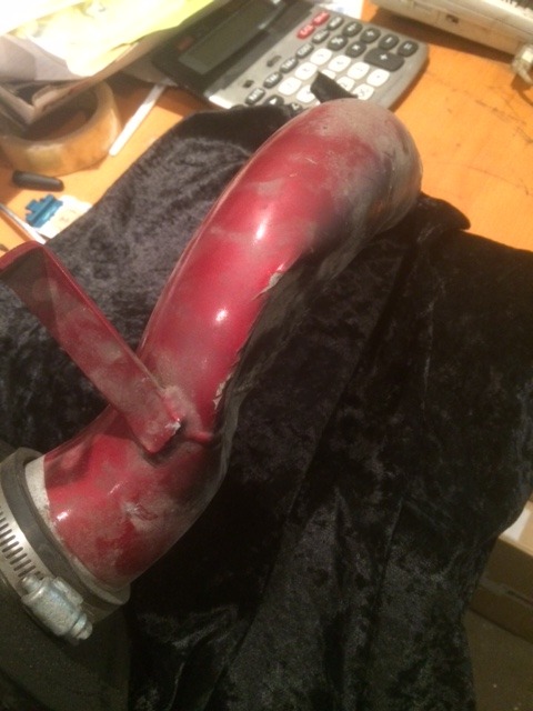

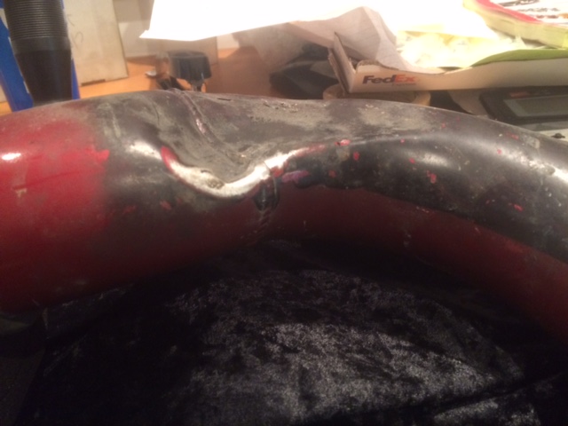

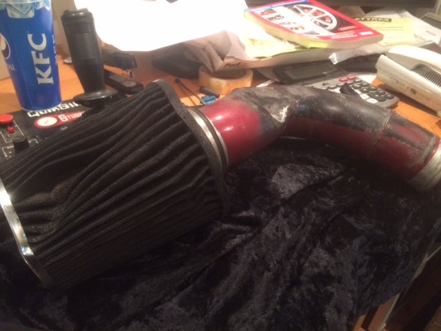

The car was fast with the rubbish intake........................now its plumb crazy, mapper says quickest thing he has ever been in, its a GT3 top end on a turbo bottom end and redlines at 8500, can do 9K but better safe than sorry, motor was built by Todd @ Protomotive, its going on a hub dyno this week.
Bad intake

was that bad intake smashed in on purpose for clearance, or did the tire do that?
no idea how anyone fits 3" intakes in there without smashing in the chassis to fit the tubing into it. I"m running 2.5" and have very little clearance, maybe 3/4" (no rubbing) and an aggressive wheel offset.

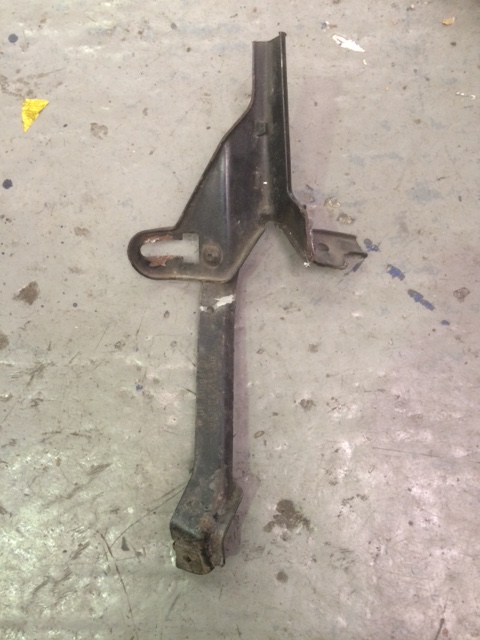

I will get pics but we are now 3" from inlet to filter and have maybe an inch clearance between inner tyre and pipework, we cut the IC cage where it drops down from the top stud
We did not have time to replace this but the IC frame seems rock steady without it, for reference the small speed clip is where the bottom inner of the arch liner screws to. I will get pics for you guys asap but we are running 315/30.18's on Motorsport centrelocks which are 1" wider than the stock turbo twists.
