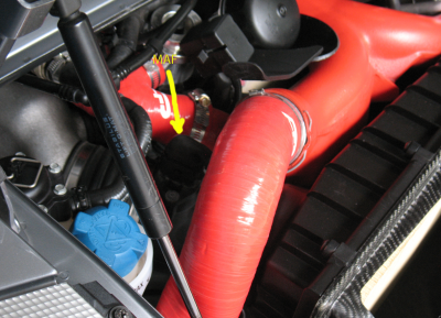

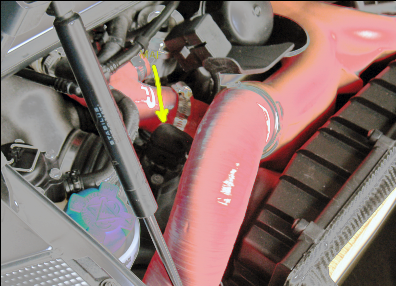

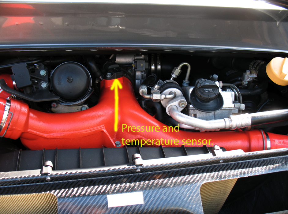

Can anyone post a picture of where the MAF is?
At the begining of the thread it says there are two bolts holding it, and the piece I thought it was only has one bolt. Am I looking at the wrong thing here?

Here it is.... I've lower the contrast on the second pic to see better... You probably looked at the pressure and temperature sensor which is located just before the throttle body and got only one screw....
