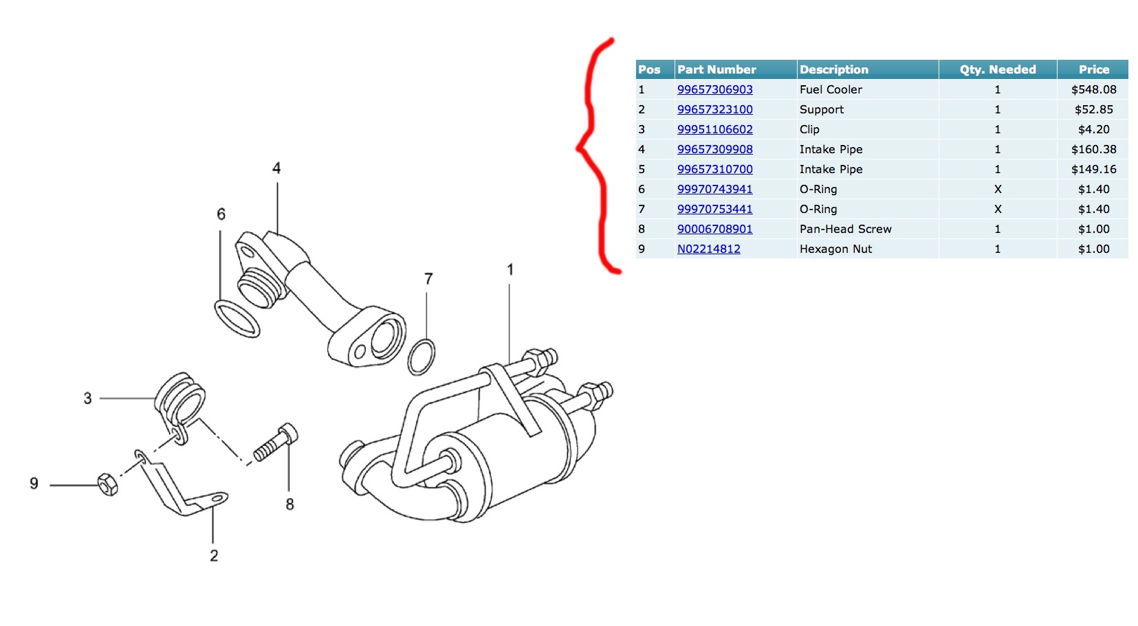

When the air conditioning is turned off the fuel cooler does not have any cooling. The european cars (ROW) don't have this feature. Weight saving can be important, pump, hoses (underside), condensers (2) and hardware removed probably represent close to 100 pounds! I saw Kevin post on Rennlist and he's talking about 30 pounds of saving… Hum, may be I'm off a little bit lol!!! But about the a/c coming on and off to cool the fuel ??????
I am correcting this sentence about fuel cooler. "The essential companion" book mention there are a fuel cooler installed on ALL 996 turbo…Sorry about this mistake

I would love to get hard data on this, both on the weight savings and operation of the mysterious fuel cooler. Seems there is a lot of conjecture on both fronts. 100 lbs seem excessive however. I was thinking about 40-50lbs myself but would love to hear from someone who's removed and weighed the stuff. I think on 997GT3s the factory delete option was about a 60lb savings if memory serves me correct.

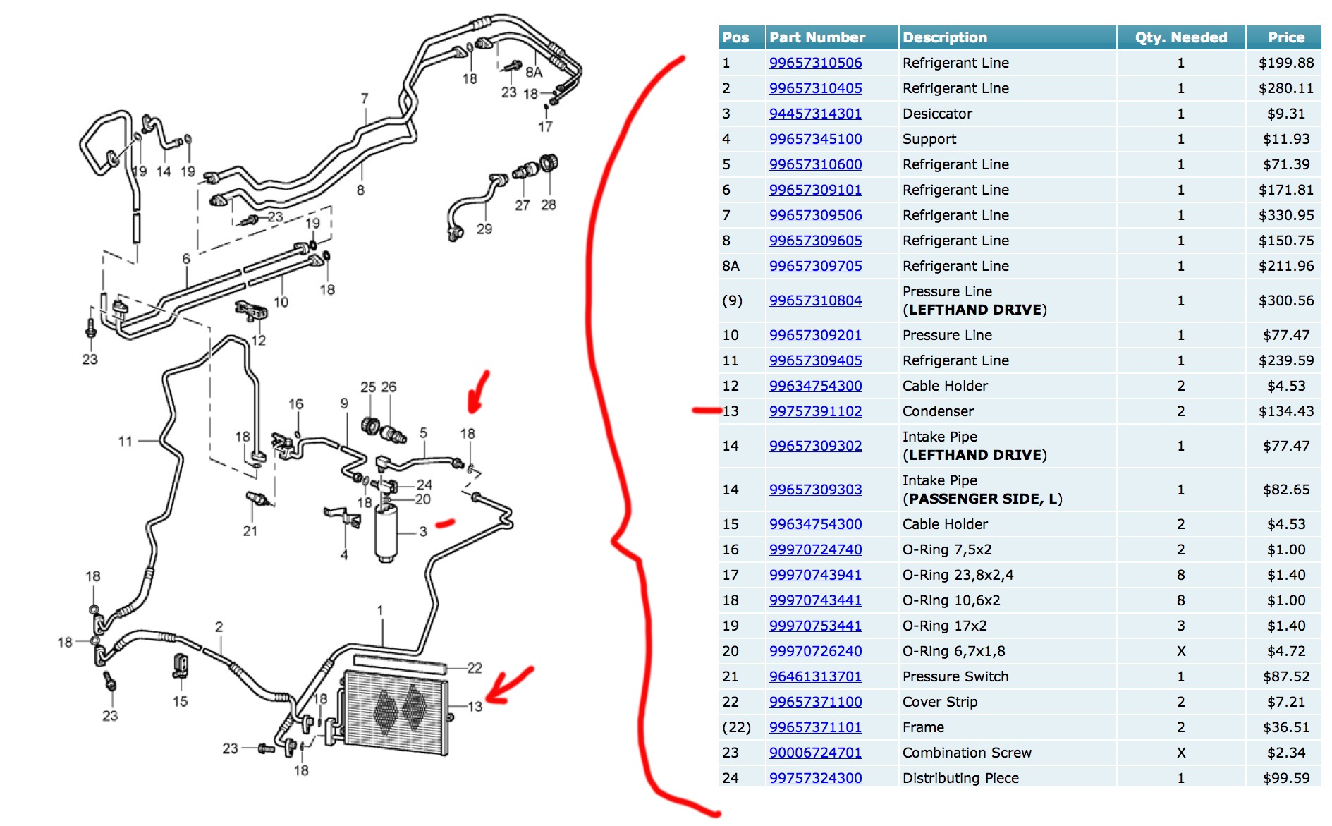

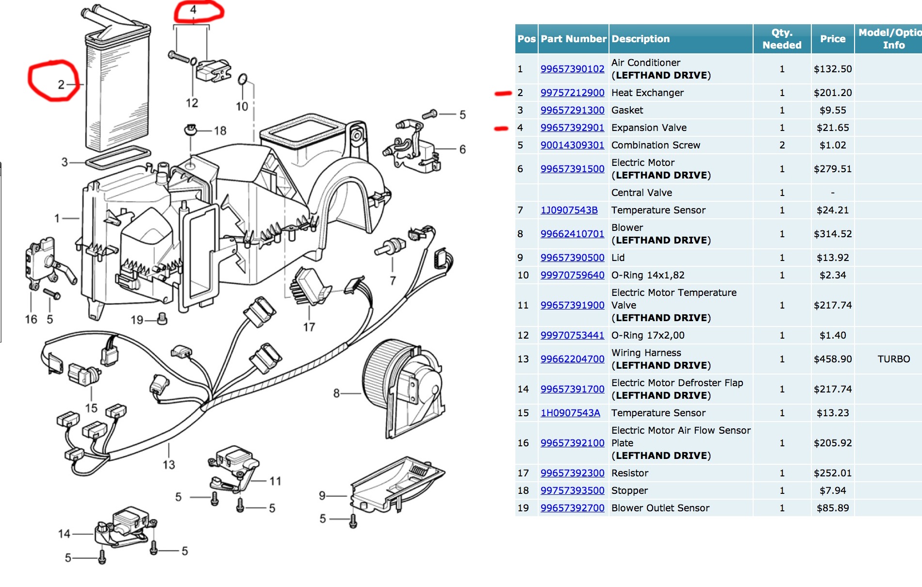

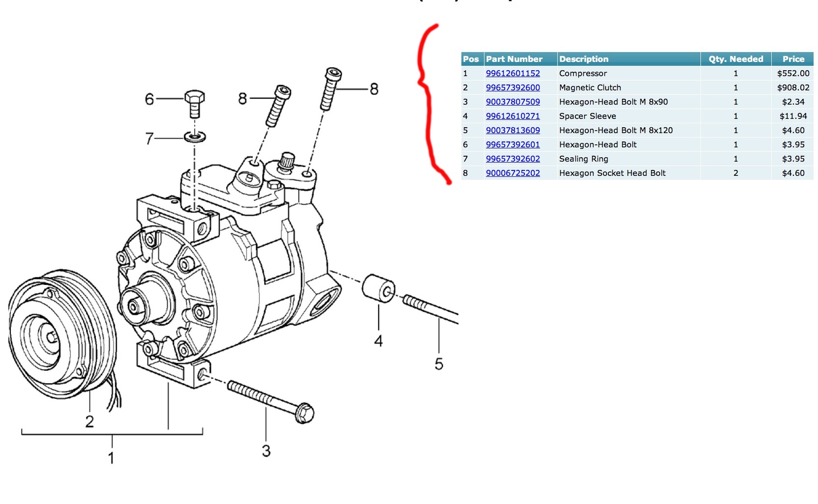

Just by curiosity I went and search different forums. A guy with a 930 save 30 kg (66 pounds removing the a/c system. Of course we are talking about stripping everything, condenser, evaporator, desiccator, expansion valve , compressor, hardware and all the lines under the car and in the front compartment. Admit it is far from 100 pounds But I'm talking about a good clean-up , Interesting subject I have to admit….

Name:	Screen Shot 2014-10-05 at 18.31.44.jpeg
ID:	404070   Click image for larger version
Name:	Screen Shot 2014-10-05 at 18.31.29.jpeg
ID:	404071   Click image for larger version
Name:	Screen Shot 2014-10-05 at 18.31.12.jpeg
ID:	404072   Click image for larger version
Name:	Screen Shot 2014-10-05 at 18.30.12.jpeg

Researching this a little more, we can actually do this mod and still make it rather easily reversible. Essentially, we can remove the heavy rear A/C compressor and the front A/C radiators leaving the lightweight aluminum piping in place. The piping would basically be capped off. This would provide the bulk of the weight loss of around 25-30lbs and still make it easy to reverse. In the rear, a 996 Cup pulley and belt would be installed in place of the stock serpentine belt. Another added benefit of getting rid of the front A/C radiators would be slightly better airflow through the main engine radiators resulting in better engine cooling.
