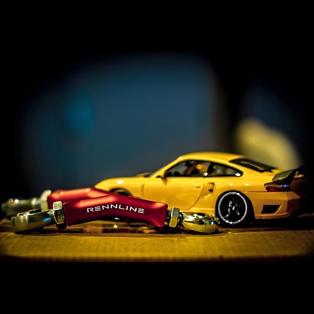

Finished installing Ohlins R/T for my AWD 996TT, along with Rennline drop links (curved front, straight rear), which I had installed 8 months ago). But the car is still in the shop for other things. Should be ready to drive next week. I'd imagine that the car will feel much different since the old suspension set is stock, from 2002, totally worn out.
In the attached photo, you can see the rear Rennline drop links. And that thick spacer is RUF.
Should I go for the following items as well?
(Would be lowering no more than 25.4 mm or 1 inch since my drive way is steep)
(track maybe 4-5 times a year)
-toe links with bump steer
-upper rear control arm links
-sway bars
If yes, should I go with Tarett or Rennline? Any other brand I should consider? Is there a big difference among these brands (suspension accessories)?
