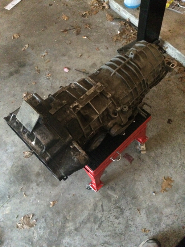

And there you have it.

stilov Is a GOD !stilov Is a GOD !stilov Is a GOD !stilov Is a GOD !stilov Is a GOD !stilov Is a GOD !stilov Is a GOD !stilov Is a GOD !stilov Is a GOD !stilov Is a GOD !stilov Is a GOD !
Did I mess up my slave cylinder? It wasn't out of the trans all the way when I dropped the trans.
It seems like all it did was pull the rod out. And went right back in. Ideas?

Congratulations Stilov!!!!

jpflip Is a GOD !jpflip Is a GOD !jpflip Is a GOD !jpflip Is a GOD !jpflip Is a GOD !jpflip Is a GOD !jpflip Is a GOD !jpflip Is a GOD !jpflip Is a GOD !jpflip Is a GOD !jpflip Is a GOD !
Remove the rubber boot at the end of the slave and you will see the pushrod is free inside….

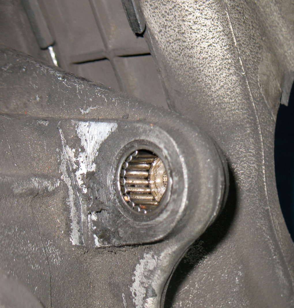

Now it is time for a good inspection , of course of the clutch, pressure plate and bearing but also the needle bearings for the clutch fork. Both sides should be inspected properly….

Stupid triple square bits I bought won't fit the clutch! M8 is like a hair too big.
Is it seriously m7?

My clutch creaked really bad prior to this, something inside the bellhousing. Kevin at UMW suggesting the roller bearings, so I need to look at everything. I really hoped to get the clutch out to figure exactly what I had in the first place.
