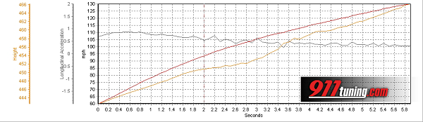

K16 billets with at least a 5 bar or injectors will do well..
Here is our billet wheel running a 60 to 130 mph record of 5.86 sec.
markski
2001 996TT 3.6L and stock ECU
9.66
seconds @ 147.76 mph 1/4 mile
click to view

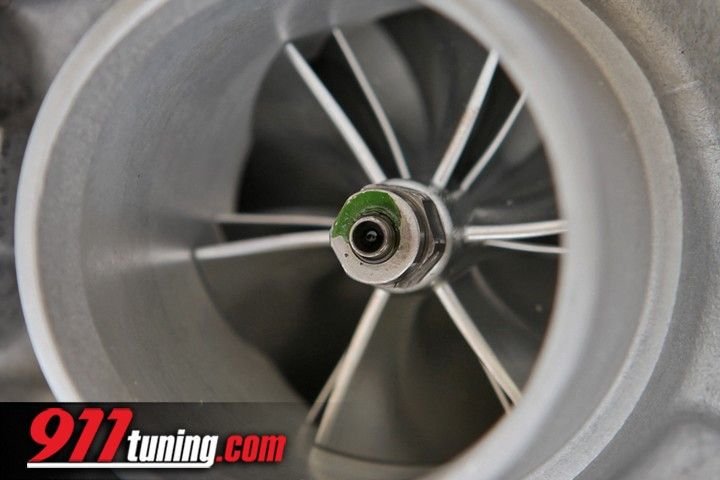

Tons of almost endless variations out there. Everyone has their own secret sauce. Below are the K16s I'm running with the 997GT2RS compressor. Quite a bit bigged than stock K24s..
