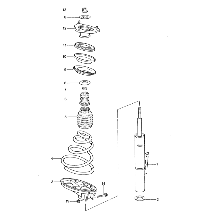

#11 here.

assuming that's the shock bearing plate you suggested upthread? would it be possible for the noise i'm describing to occur while the car is stationary yet simply turning the wheels? that doesn't seem to be shock or mount related. in fact, it minimally occurs ( or i hear it less ) while i'm actually driving. it sounds like rubber ( boot ) binding after a slight tear. if i had to guess!
i wouldn't think that bearing plate part to be impacted. do you know differently? ..and thx.

How could it be CV boots when turning the wheel? You have no axles in the front Mark. If your upper mounts are shot, they will make a crunching sound when turning the wheels.

sinKing's Avatar
Joined: Feb 2011
Posts: 1,120
From: Austin
Rep Power: 183
sinKing Is a GOD !sinKing Is a GOD !sinKing Is a GOD !sinKing Is a GOD !sinKing Is a GOD !sinKing Is a GOD !sinKing Is a GOD !sinKing Is a GOD !sinKing Is a GOD !sinKing Is a GOD !sinKing Is a GOD !
The bearing plate allows the spring to turn when you turn the wheel against the shock mount which is fixed.
Also, check the lower ball joint.

posted up in my thread, but #11 in the diagram above is what I was referencing. It is part number 996-343-501-00-M100.
Also agree on the mounts being shot. If you want to retain your current geometry Tarett makes an AWD strut mount (the one that cants backwards). I'm sure there are others too.

yeah, i'm all over it, thx. option c was on the table when i went rwd half ****d, and appears to have come full circle. depends on what is/isn't toast. that'll make my decision for me. issue becomes can't really suss out the bearing plate and internal parts without removing them, and once in? all needs to become new again, the way i see it. ugh. i'll know next week hopefully. but someone did pass along ira's contact info as well. i'm in good hands. thankfully.. and thx for the advice/input ( everyone ). i'm getting schooled.

my votes is on #11. CV boot is a close 2nd. I actually had this same diagnostic dilemma years ago (around 55k miles). It actually turned out to be BOTH in my case. The CV boots fixed part of the sound ( a ticking/crunching), but the creak/ground with turning the wheel persisted.

add: wait! what was the other fix beside the boot?!.. bearing plate #11. duh. got it. thx
