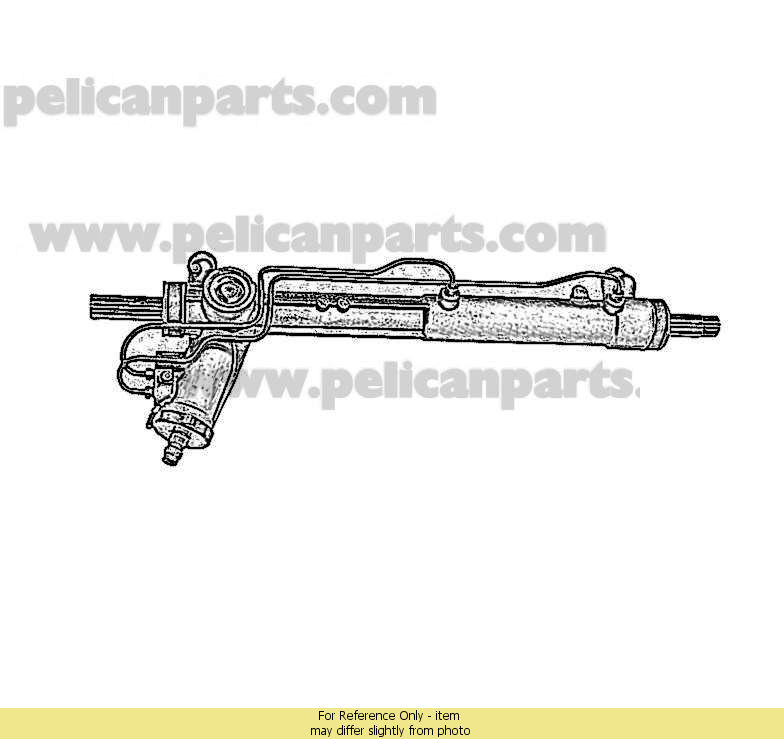

update:
car has a small brownish puddle and cpl drops of a viscous brownish fluid slightly oily ( not coolant ) emanating from the lower right front @ bottom of the front lip. couple of drops hanging on it, and small pancake sized puddle directly under same spot which has not yet dried. i have never seen brown fluid come from the car before.
could it be grease from a torn cv boot anyone?? is this possible?

but i think i have a bigger fish to fry, steering rack. my tech just told me he believes that may be what I've toasted. i gotta drive down to "tha hood" and get it looked at, hoping later today. it IS after all leaking pentosin it seems, though it didn't seem "oily" like pent usually feels/looks. looked like brownish brackish water.
Ah yes... I had to do this one also. If memory serves me - there are TWO ways to replace it. There's a rebuilt part and an OEM one. Somehow, I think the reman one was the way to go as it included the entire sealed assembly. The good news is that the steering was vastly improved after replacement.
I would never have known there was something wrong, but after replacing it - it felt like a *new* car!
found it. 450/500 @ pelican. will diagnose today, order tomorrow once me and my bud get under it later today. thx all
