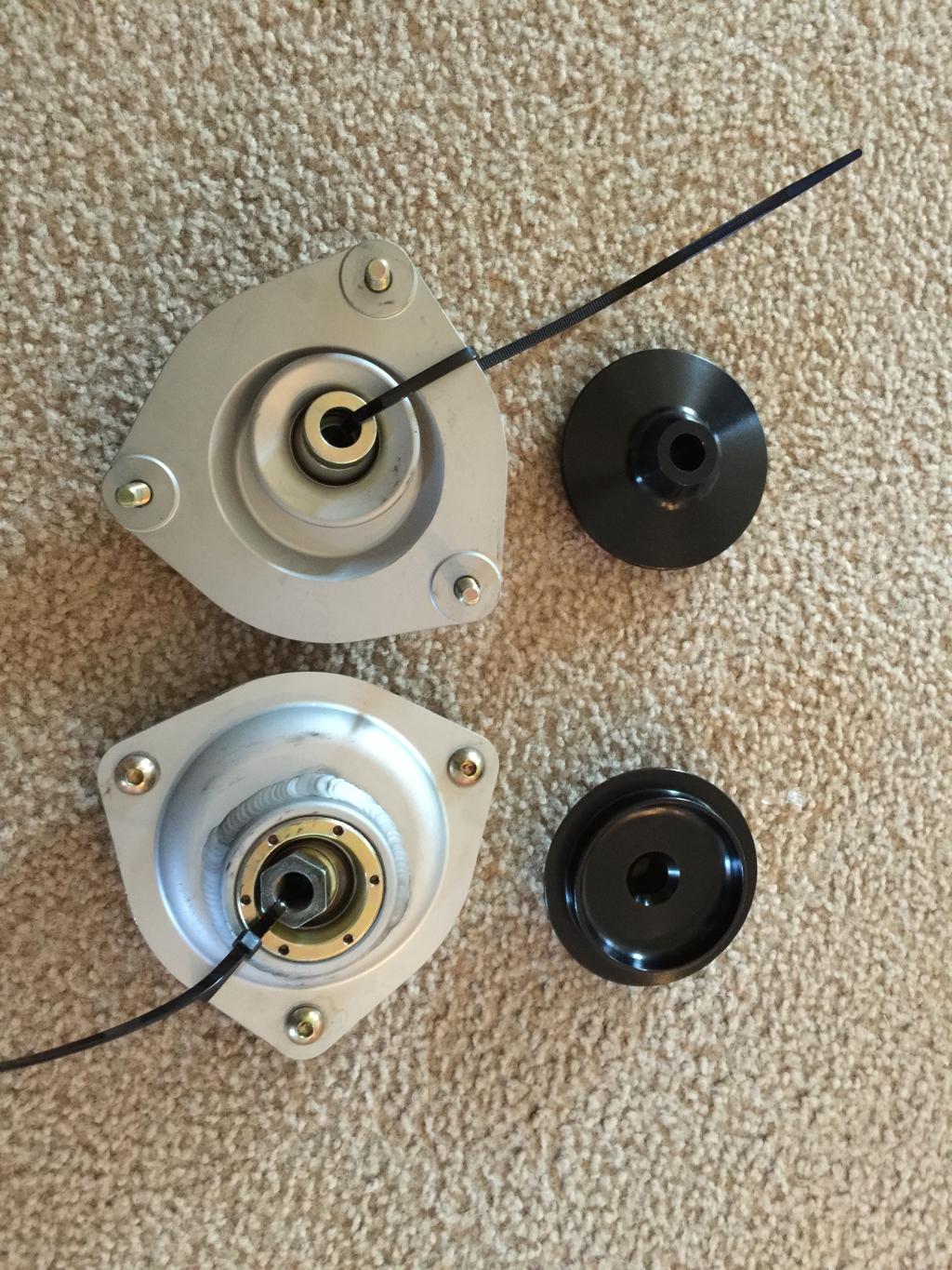

Old Dec 29, 2014 | 06:13 AM
  #59
'02996ttx50's Avatar
Joined: May 2009
Posts: 7,984
From: la
Rep Power: 607
Originally Posted by 32krazy!
maybe these?
will these do? anyone?
( thx again steve..)
ID:	410787   Click image for larger version
Old Dec 29, 2014 | 06:39 AM
  #60
rmc1148's Avatar
Joined: Jul 2012
Posts: 2,382
From: kirkwood pa
Rep Power: 434
I always replace complete suspension on higher miles cars that I own as its easier done once. I agree with pwdrhound as far as keeping mainly stock unless you do a lot of track use. There are 100s of opinions and choices that go deeper into your pocket but unless your on a track and counting seconds the difference wont be missed.
