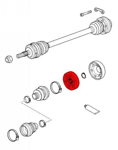

^.....that,.. and i'm having a hunch it could be cv joint(s). no telling when they were replaced since it hasn't been me. i'm headed down the rabbit hole of suspension parts lol

Originally Posted by rmc1148
They usually make noise when turning and more of a grinding sound but maybe lol.
this is the critter I'm thinking..it's more of a "crunch" but a crunch is as good as a grind to a dead horse lol
