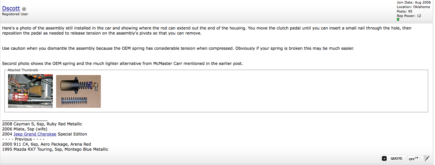

Helper spring DIY
There's several write ups on a DIY for this mod on this forum...unfortunately, I don't remember the links...do a search.
I did the Home Depot spring and found it better for me...I'm use to heavier racing clutches but I find this setup the best clutch feel...although, many like the MacMaster spring...I find it still helps me too much.
I've attached a couple of screen pix of the post...hope these help...btw, use the broom stick technique to put the helper spring unit back in...it's a god send!

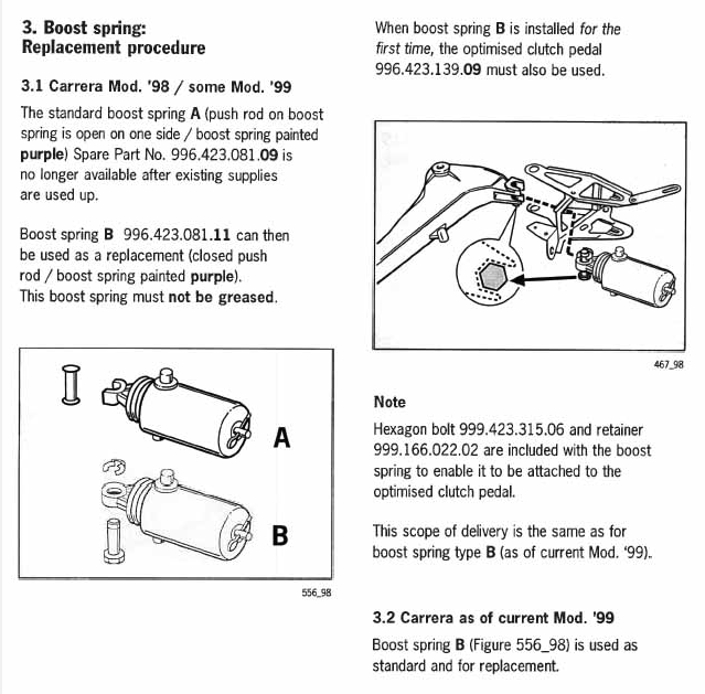

Also, as shown on the last attachment, be sure the Hexiganal end of the bolt is in the correct position...it's side specific...one side round, one side hex shape...
The HD spring is $4.89 and the MacMaster is about $3 each...you have to buy a bag of 6 springs + shipping charge.
